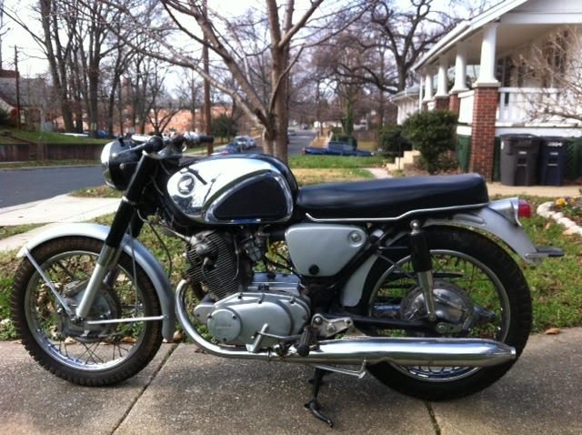

Post by Jlovvorn » Fri Jan 13, 2012 7:28 pm
Gentlemen, we have a clutch....
Just got back from first test drive.
Only took hours of free tech support on the phone from LM.
Full report to follow, but short answer is "wrong number and thickness of plates in the basket."
Now, I need to deal with the two stripped left cover bolts that are leaking oil everywhere.....
