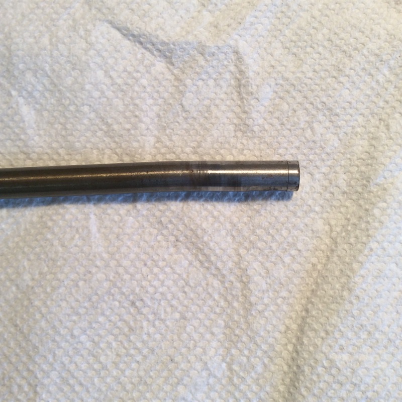

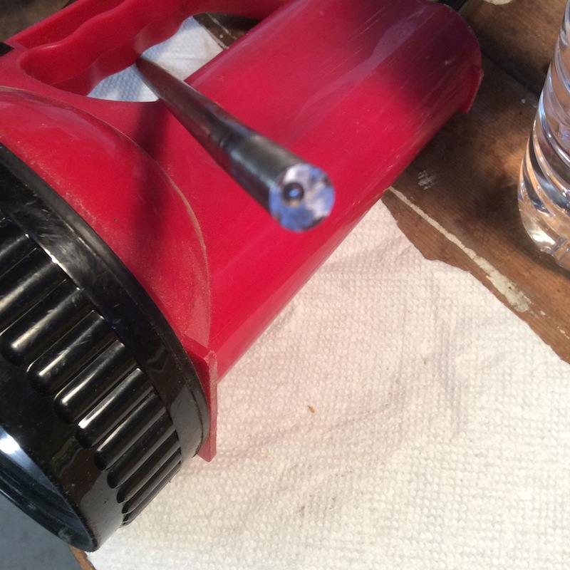

Messing about in my right case area today and noticed that the clutch actuator rod is bent, flattened a bit and scored on the portion inside the case. The detent for the ball bearing is also off center. Any idea how this happens? Before I buy a used replacement, is there any variation in early or late model rods that I should know about? Mine is approximately 9-11/16 inches long. The seal should also be replaced. Hopefully I can find one at the Honda dealer.

Maybe the drive chain came off and caught it......

Thanks, G-Man. I guess anything is possible. The fact remains that I have to replace it and the seal. Will any CA77 clutch rod do, or must I find a specific one for my '64?
Post by LOUD MOUSE » Sat Jan 31, 2015 5:27 pm
That part is the same for all 250/305 engines. ........lm
Seadog wrote:
G-Man wrote:Maybe the drive chain came off and caught it......
Posts: 1273
Location: Cape Cod, MA
Post by Seadog » Sat Jan 31, 2015 6:01 pm
LOUD MOUSE wrote:That part is the same for all 250/305 engines. ........lm
Thanks, LM. Now I can order one right away. Do you know if seal is still available?
Post by LOUD MOUSE » Sat Jan 31, 2015 6:29 pm
I can supply both. ........lm
Posts: 1273
Post by Seadog » Sat Jan 31, 2015 6:35 pm
LOUD MOUSE wrote:I can supply both. ........lm
Great; email sent. Thanks
