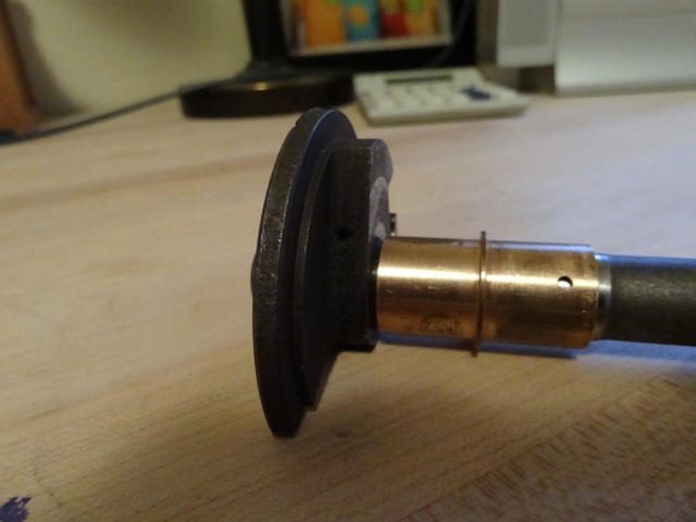

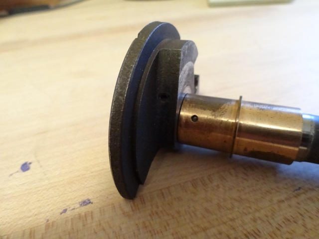

14mm bushing installation
- Posts: 7817
Re: 14mm bushing installation
The bushing has one end with a taper on the inside.
That end goes to the left of ya pic.
Put the bushing on the KS and when it's correct ya will see that it fits almost flush to the shaft/end.. ................lm
gopher wrote:Is this the correct way to install the 14mm bushing?
