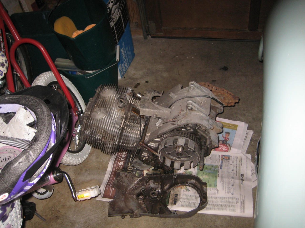

Thanks all for the helpful information and offers on replacements parts. I was extremely lucky and caught a local Craigslist posting for CB77 engine. A short drive and $47 later I've a lot of replacement parts for future use, including the little clutch adjuster casting that I had shattered. Last night I had enough open time after work to clean things out, install seals and button things back up. I've adjusted the clutch (not over tightening this time!) and it seems much smoother going thought the gears - and finding neutral is a breeze. The weather has gone down hill again (39 deg and sleeting), so it may be a bit before I haul it out on the road to check full operation and the utility of the new seals. Thanks again for the kind advice and support.

I thought the CB77's were dual carb bikes? That motor is a single.Erik C wrote:Thanks all for the helpful information and offers on replacements parts. I was extremely lucky and caught a local Craigslist posting for CB77 engine. A short drive and $47 later I've a lot of replacement parts for future use, including the little clutch adjuster casting that I had shattered. Last night I had enough open time after work to clean things out, install seals and button things back up. I've adjusted the clutch (not over tightening this time!) and it seems much smoother going thought the gears - and finding neutral is a breeze. The weather has gone down hill again (39 deg and sleeting), so it may be a bit before I haul it out on the road to check full operation and the utility of the new seals. Thanks again for the kind advice and support.
