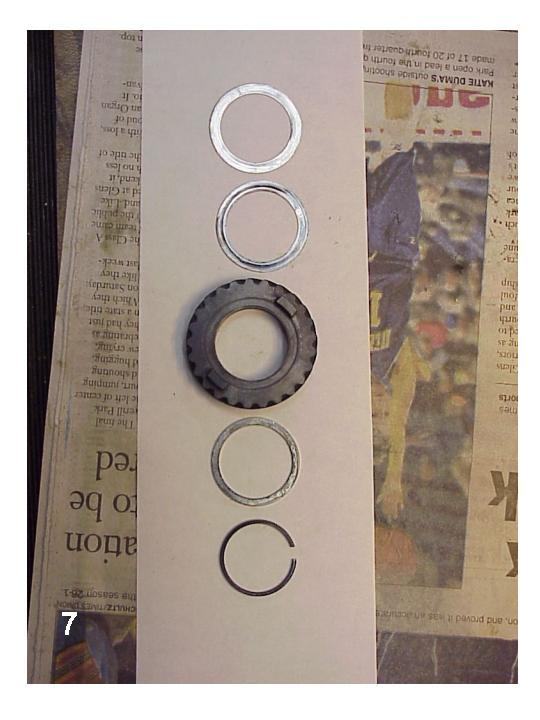

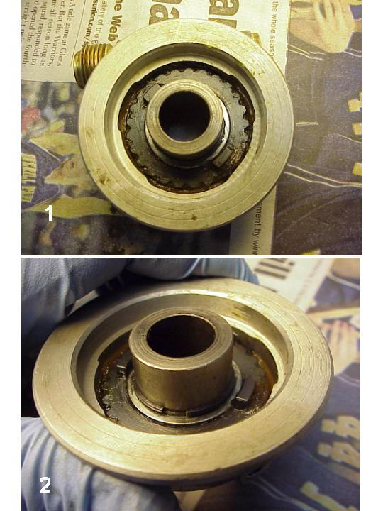

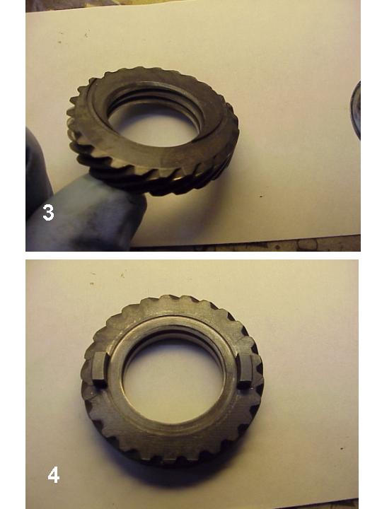

For those who might be asking in the future, here's a step by step and photos of the parts.
1. Warm the housing with a heat gun or torch (be careful not to over heat) to allow the seal to be removed without damage. Pry seal with screwdriver or similar, not forcing. Heat the housing so it is not too hot to hold and let it heat soak. This will loosen up the old grease that holding the seal in place. Light pressure is all that is needed once the heat has done it's job. Photo 1 shows the assembly with the seal removed exposing the drive gear. Grease has been cleaned out here.
2. With the seal out, swab out the old grease or scoop out with a small screwdriver or spatula until you can see the drive gear and the snap ring that holds it in. Photo 2 shows the snap ring. Also notice the silver thrust washer on top of the drive gear.

6. Now clean the removed parts. The drive gear is shown in Photos 3 and 4. Note the grease grooves in both the back face of the gear and the inner diameter. Clean these grooves out well. Clean the shims, thrust washer and snap ring and set aside. Don't forget to clean the seal if being reused.

8. Photo 7 shows the internal parts in the order of assembly, from top to bottom. From the top, install the shims, then the drive gear with the lugs facing out, then the thrust washer and lastly the snap ring.
