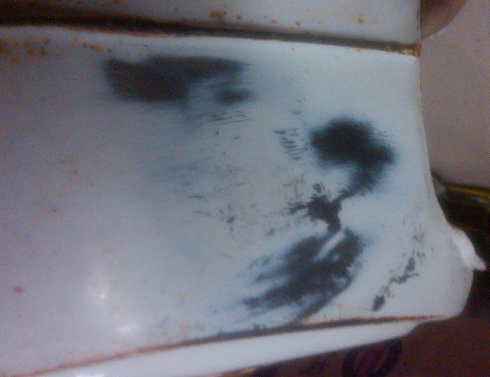

removing dent from tank?

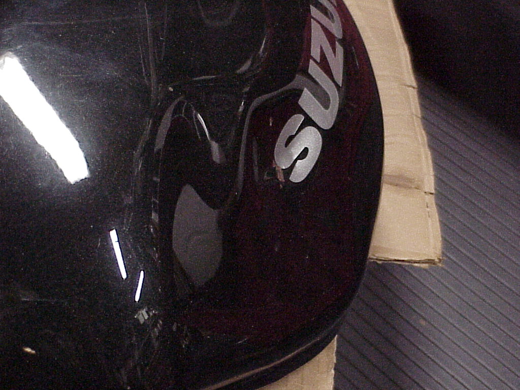

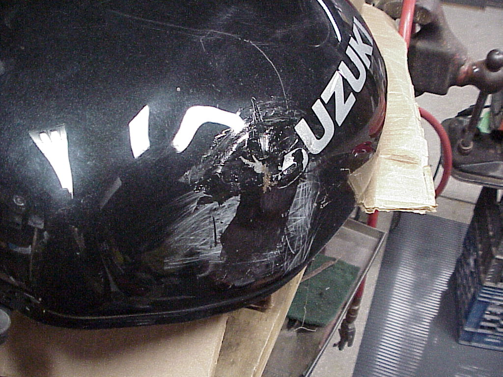

I've attached before and after pics of my SV tank. This was the first time around. Note that I did scuff up the paint because I wanted the glue to bite better and was repainting anyway. Plus this was the first time I ever tried doing this. Notice that the paint remained and only the S decal pulled off.
Dreamed up the idea one night and figured it could not hurt to try. The smaller dents are harder to pull because you cannot make a small tool and still have enough surface area for the glue to hold well enough to pull. In such a case you could braze a nail to the dent and pull using the slide hammer then simply remove the nail by reheating. In case it is not obvious, you braze the head of the nail to the tank. You can put a hook in the nail shank to grab with your slide hammer.

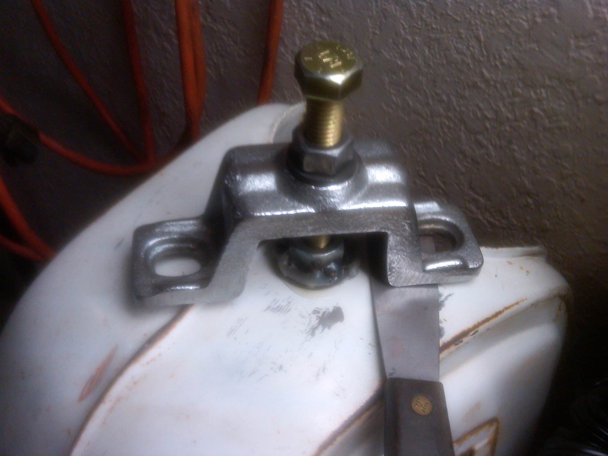

Results;
Started with the glue gun and slide hammer. I decided to try a puller, more gradual pressure. I glued the puller on about 5 times before I got it to pop out. Luckily the dent was in a spot I could bridge pretty well. The dent come out pretty well. There are three small dimpled areas that I have yet to work out, one of which is next to the seam so it probably won't come out. I've constructed an end for a small slide hammer but haven't had time to work on it much more. I may adapt it to the puller as well. Even if I can't do any better the spots can easily be filled as they aren't very deep.
I'm pleased with the results, thanks for the input everyone.
One thing I noticed was that on the painted surface the glue didn't seem to hold too well until I sanded it with 150 grit sandpaper and cleaned the residue off well. I heated the surface with a heat gun prior to putting on the glue, in warmer weather it probably wouldn't be necessary.
