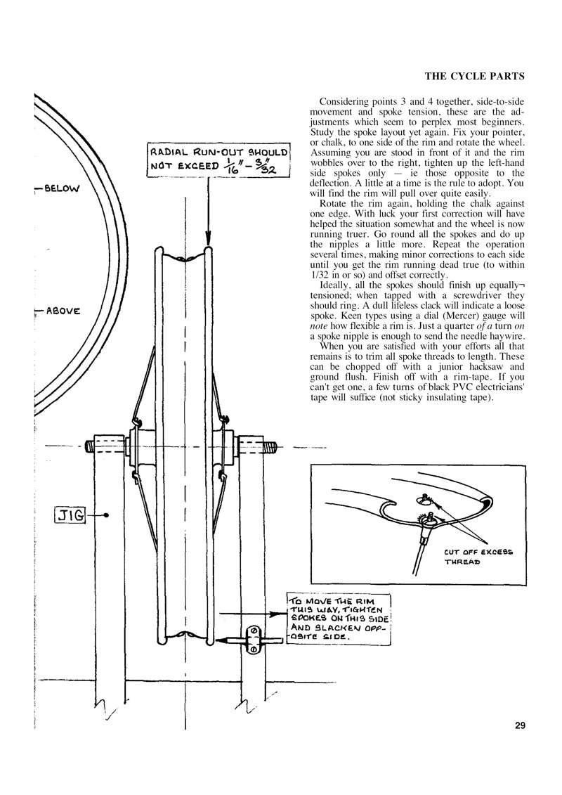

If the wheel was just built badly, it should be possible to true it. I have built many wheels. You just need some kind of fixture - a set of forks will do - and a marker to gauge the runout.
Once you are set up, it is just a matter of loosening the spokes on one side of the hub and tightening the ones on the other. The adjustment is spread across the whole area that needs adjusting and you have to keep an eye on eccentricity (vertical runout) as you are adjusting the lateral.

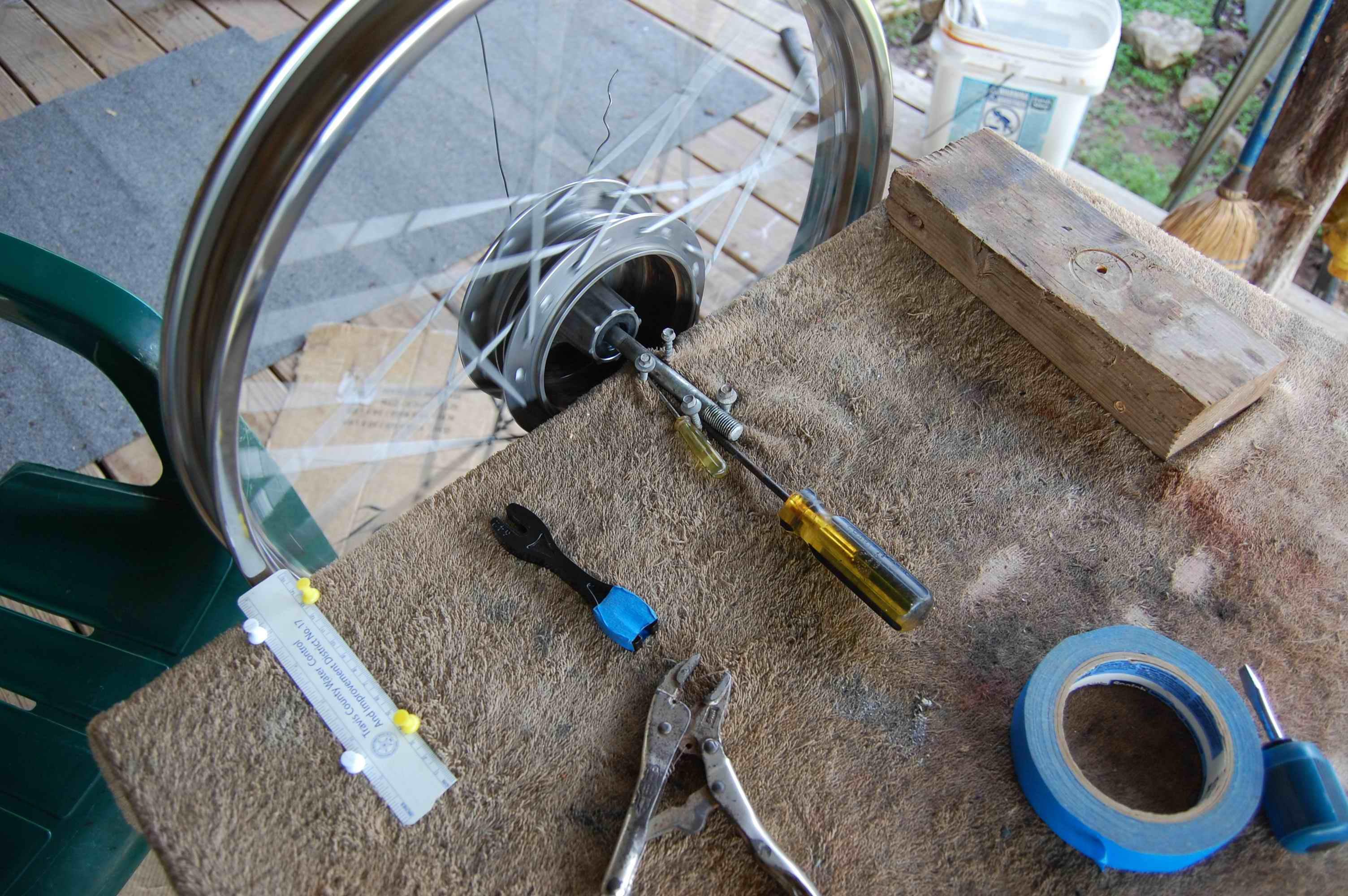

back porch truing
Here's a photo of my thrown-together truing setup...(pic from yesterday, a new, non-305 project). Outside of axle is supported by a wire from a rafter...study up, it's not that hard once you get the hang of it, just tedious, time consuming, attention demanding. Good luck. --Lee
