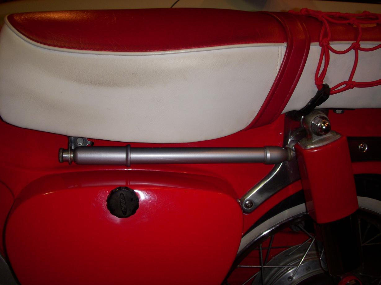

Anyone have a tire pump or a good photo of how the tire pump mounts on the CA77.thanks

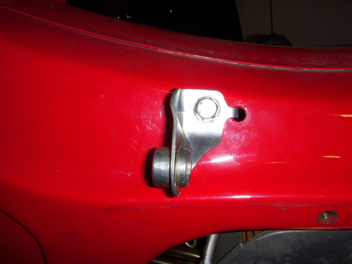

here are a couple of pics from a ca72, pump mounts with brackets at both ends and end nearest fuel tank has a lock on it. Just repainted the pump tonight to mount to my ca77.

Thanks-Does the lock match the ignition key?Would the mounts use existing holes on a CA77.Any close-up shots?

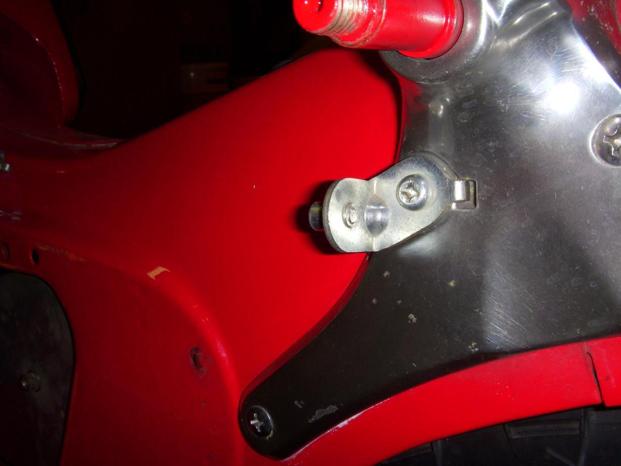

No it's a seperate key and yes the mounts bolt up to existing holes, one hole in the rear support bracket and a hole by the front of the seat usually has a rubber plug in it from the factory. When I mount it on the other bike I will try and remember to get some more pictures. The locks are the hard part to find, brackets are on ebay and pumps show up there once in awhile.

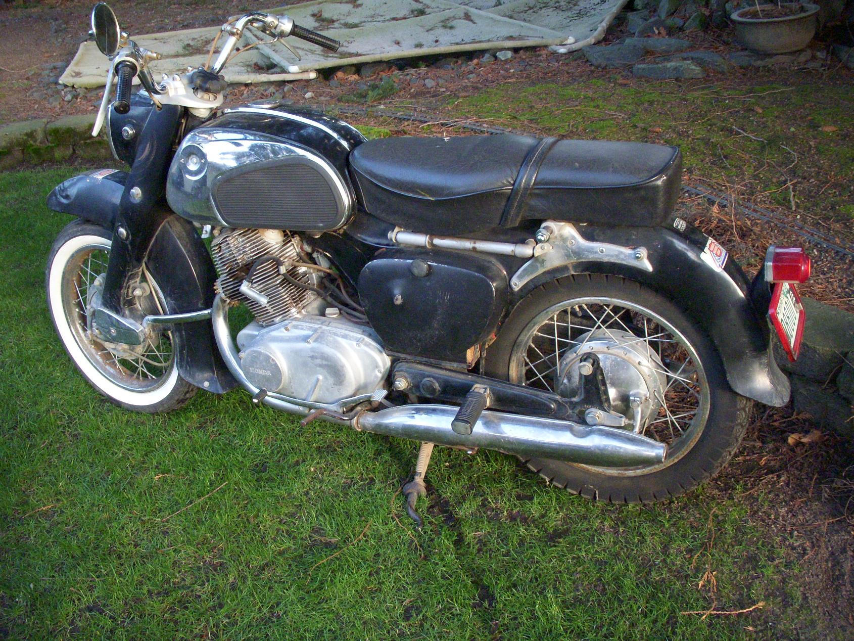

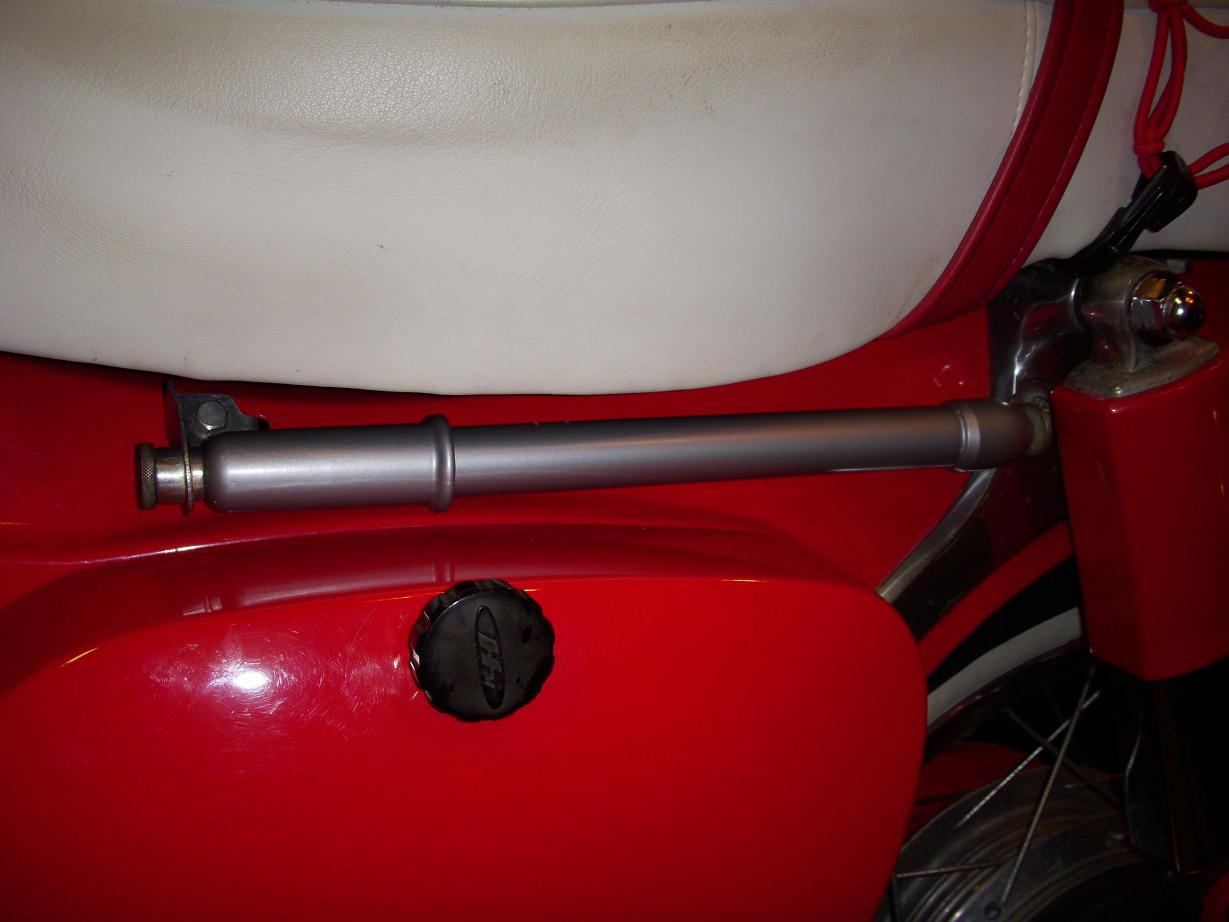

Here are some pictures of a pump mounted on a Ca78
On bike
On bike
On bike
On bike

Rear mount
Rear mount
Front mount
Front mount
