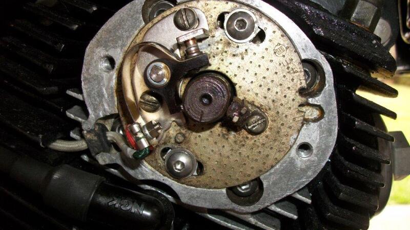

Re: 1969 CA77 Condenser
G’day quidger
You’ve made more progress - which is a good result.
One final check, that you may have already done, but just in case…
As the points just start to open and the static test lamp just comes on, the line on the end of the camshaft at the points, must be facing downwards. The attached photo shows this. If this is incorrect, the valve timing will be incorrect. If not already done, please check and confirm this is OK.
Now check the 4 valve tappet clearances to ensure nothing is wrong there (unlikely, but possible).
Remove the air cleaner and air hose from the carby.
Now make up a jumper wire to bypass the condenser. Connect the green wire out of the coil to the screw terminal on the points and leave the condenser out of the circuit. Check the points timing again. With the “F“ mark on magneto rotor aligned with the pointer of the crankcase, the static timing light should just come on and the line on the crankshaft at the points should be facing downwards (as shown in the photo).
Now we know that the engine valve and points system is timed correctly and we can try and connect the condenser.
Try the original CA77 condenser first. After it is connected, try the static timing again – make sure it is correct.
Check and ensure you have a good strong spark at both spark plugs while cranking the engine over and the spark plugs out of the engine and grounded against the motor.
If you have good spark, the valve and spark timing is correct and the carby is OK, the engine should start. These engines are “cold” engines and generally need plenty of choke (enricher). If it still does not start, check the spark plugs to see if they are wet or dry. Wet means it is getting fuel, dry means no fuel.
Put the plugs back in and try some starting ether in the carb intake while cranking the engine. It should start. If not, then I’d say something is incorrect with the above procedure so recheck and confirm.
If you get spark at the plugs without any condenser, but no spark with the CA77 condenser we can try the CL77 condenser next. First, just let us know how the above goes.
