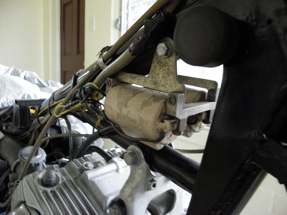

Hi all, My CL77 had been dropping the right cylinder when starting then it would seem to be ok after running a little. Well now it runs on one cylinder and if it picks up the right side it cuts out as I give it some throttle. I checked all the connections and got a new plug cap and plug, then I swapped the plug leads and the problem changed sides so the right coil appears to be toast. I have seen several threads on Dream coils but mine has 2 separate coils and I am appealing to the members here for the best solution. A search on the web produced zero results for NOS coils...So, What do you guys use and who do you get them from? Thanks, Tim in Florida.

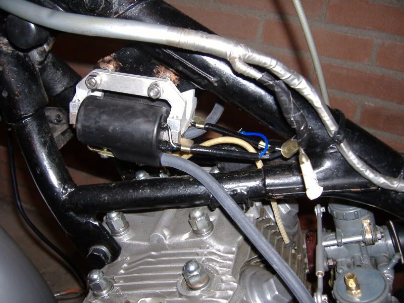

Coils for the CB350 are exactly the same, I use them as well, the only difference is the bracket.
With a bit of creativity you can install them just fine.
