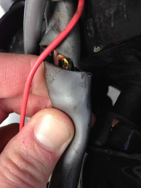

I actually just found the problem. I found it strange it wasn't attempting to draw power at all, didn't dim the lights or anything, and I found a busted wire that was getting caught against the tank and fork from turning the wheel. Happened on my old S90 too, should have thought to look there sooner.
