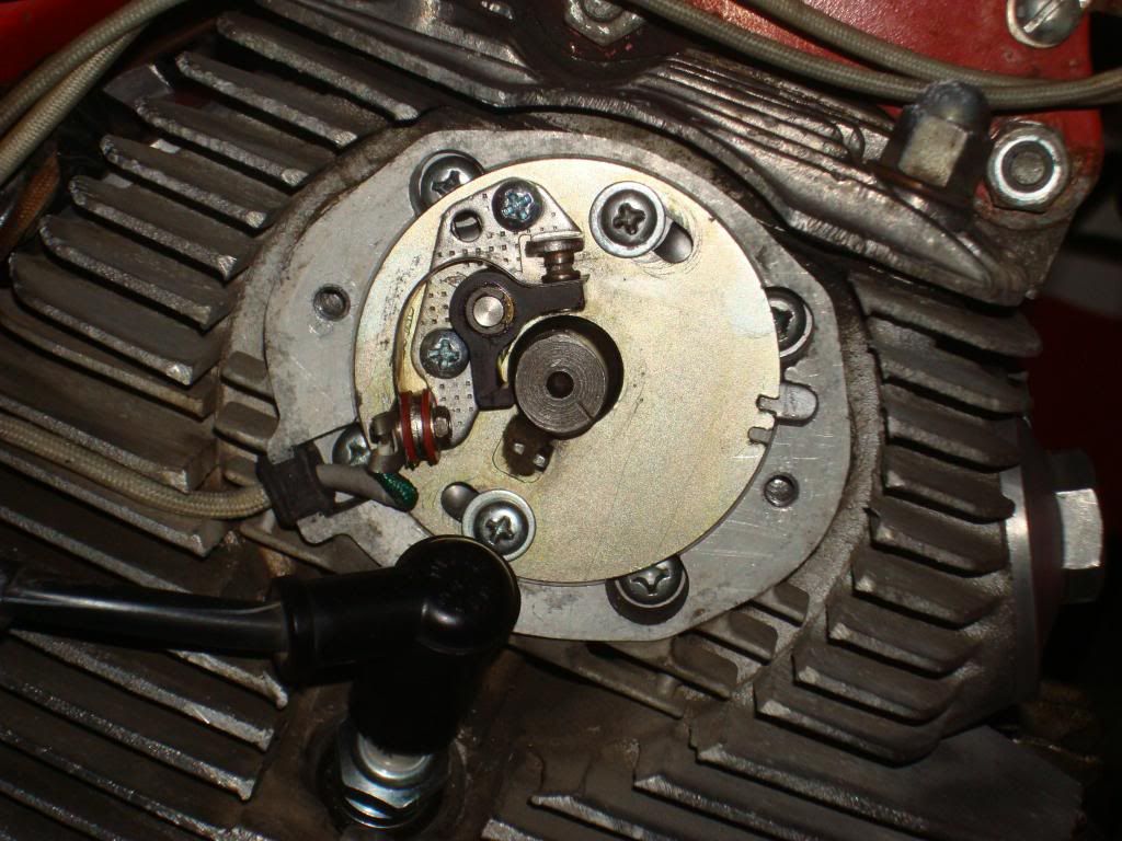

Post by Repsol » Sat Mar 08, 2014 7:12 pm
Here is an image of the points that I have. Thought they may help if someone sees anything strange in there.

Post by 48lesco » Sat Mar 08, 2014 7:38 pm
Hey Rep - I'd say it was Pure Coincidence because if you have spark on at least one side, that means there's nothing wrong with the points. Each time the points open, both plugs fire even though one of the cylinders is on the exhaust stroke and that spark is "wasted." I do believe I see some original resistor caps there though. If that's the case, I'd replace those or at least cut a 1/4" off the left wire and reinstall it. Got to be something between the coil and the spark plug (wire, cap, or plug). But if it ain't broke now, maybe don't fix it! New NGK 5K resistor caps are cheap and the plugs can go bad too.

Post by Repsol » Sat Mar 08, 2014 7:58 pm
Thanks for the reply. I was wondering why there was only one point and two spark plugs. That makes a lot of sense. I don't plan on taking the Dream cross country or anything like that so if one plug starts acting up I'd be able to limp home. Both wires look a little worse for wear so maybe I'll replace them.
