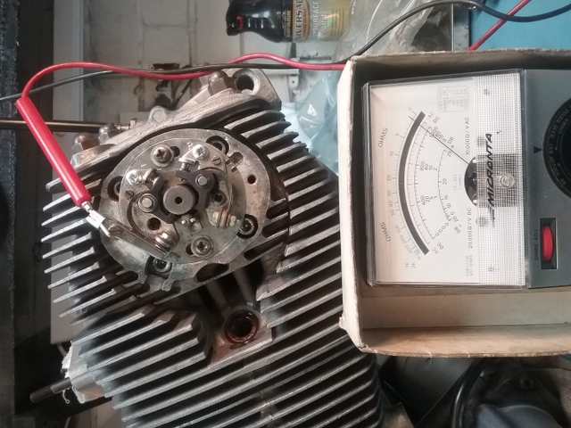

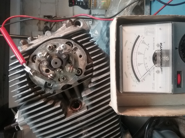

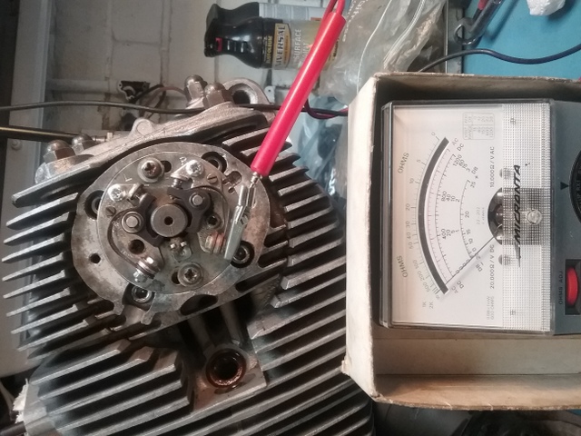

Loud Mouse is of course correct but a bit more explanation may be useful to less experienced forum users. Cam timing is set with the right side piston at top dead centre, the O on the cam sprocket vertical with respect to the mid line of the cylinders and in this position on the 180 degree CB motors the line on the points cam is also at 12 O 'clock. Timing is however set on the overlap stroke (end of exhaust beginning of intake ) with both valves open. Since the cam shaft rotates at half engine speed a further 360 degrees of crank rotation bringing the right cylinder up to the firing position on the compression stroke takes the line on the points cam through 180 degrees so that it is pointing down at 6 O'clock as Loud Mouse states. Since these are 180 degree cranks the left cylinder fires 180 degrees after the right cylinder and in this time the cam shaft has turned through a further 90 degrees such that the line on the points cam is now at the 9 O'clock position. I hope the following pictures will clarify this. First shows right sided points closed just before firing position with line on points cam almost at 6 O'clock, second shows points just opened with line on points cam at 6 O'clock as LM states,. Third picture is taken without moving the crank but ohmeter has been swapped to the left side points which are closed, final picture shows camshaft rotated a further 90 degrees ( 180 degrees crank rotation ) and left side points just opened with line on points cam at 9 O'clock. Hope this helps.

PhilD wrote:Loud Mouse is of course correct but a bit more explanation may be useful to less experienced forum users. Cam timing is set with the right side piston at top dead centre,
