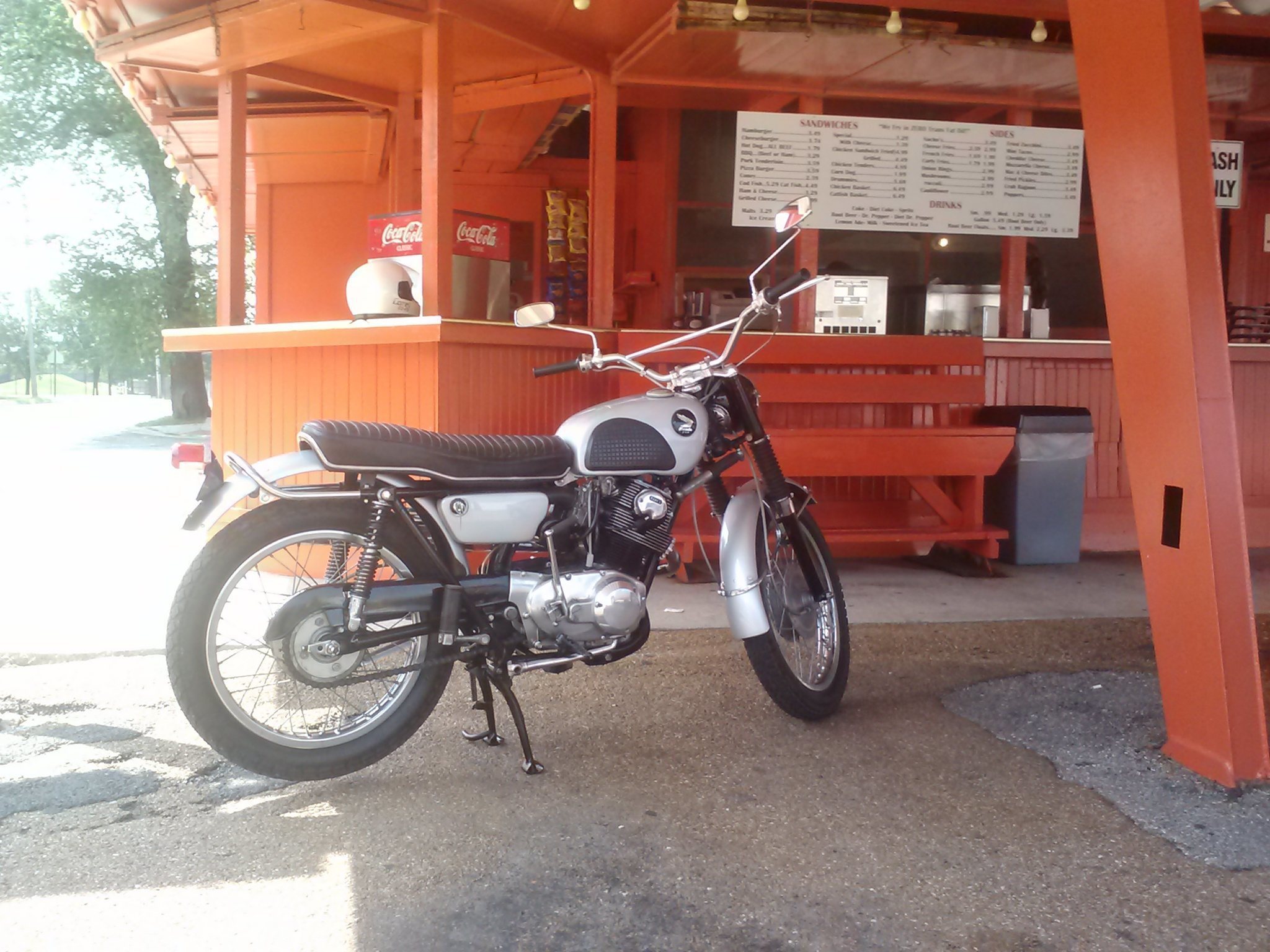

I installed the Charlies Ignition system two years ago. I put a lawn mower 12 volt regulator on that I bought on Ebay. I have ridden about 3000 miles. It has been the best improvement that I have made on my 1966 CL72. It starts so easy cold or hot and never spits or misses. [/img]
Picture of my CL72 taken last year at our outdoor open air RootBeer stand still open for its 60th year
cl72 resize.jpg (474.59 KiB) Viewed 5498 times
