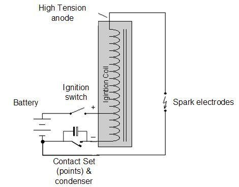

Uh uh! The condenser is an electrolytic capacitor. The points allow the coil to charge magnetically and then, when they open, the magnetic field collapses and a high (20KV or more) voltage is produced within the coil (inductor). The capacitor is used to absorb the back EMF (Electro-Magnetic Force) from the magnetic field in the coil and minimizes points burning thus maximizing the points' life. The CB's type-1 dual condenser -- one for each set of points (contact set) -- is connected at the coils (can't comment on a type-2 motor). It can be connected anywhere in the ignition's LT (Low Tension) -ve circuit that is convenient to the system, mechanically-speaking. Hence the CB has it's condenser(s) mounted alongside the coils and the -ve ccts' legs are 'sent' to ground via the contact sets via a long, heat-resistant-material-covered pair of wires.I'm also wondering about the circuitry of this condenser. My 66 Mustang has a condenser that has a wire going to the points and it the bodyof the condenser is screwed into the distributor where it's grounded. As we know the 305 condenser has two wires, one leading to the ponts and a second one connecting to a 12V hot wire. Why is it different in a car?
Most car manufacturers used to fit the condenser on the distrubutor itself. Any conventional traditional coil/contact set ignition system requires one condenser for one coil for one set of contacts (points).
