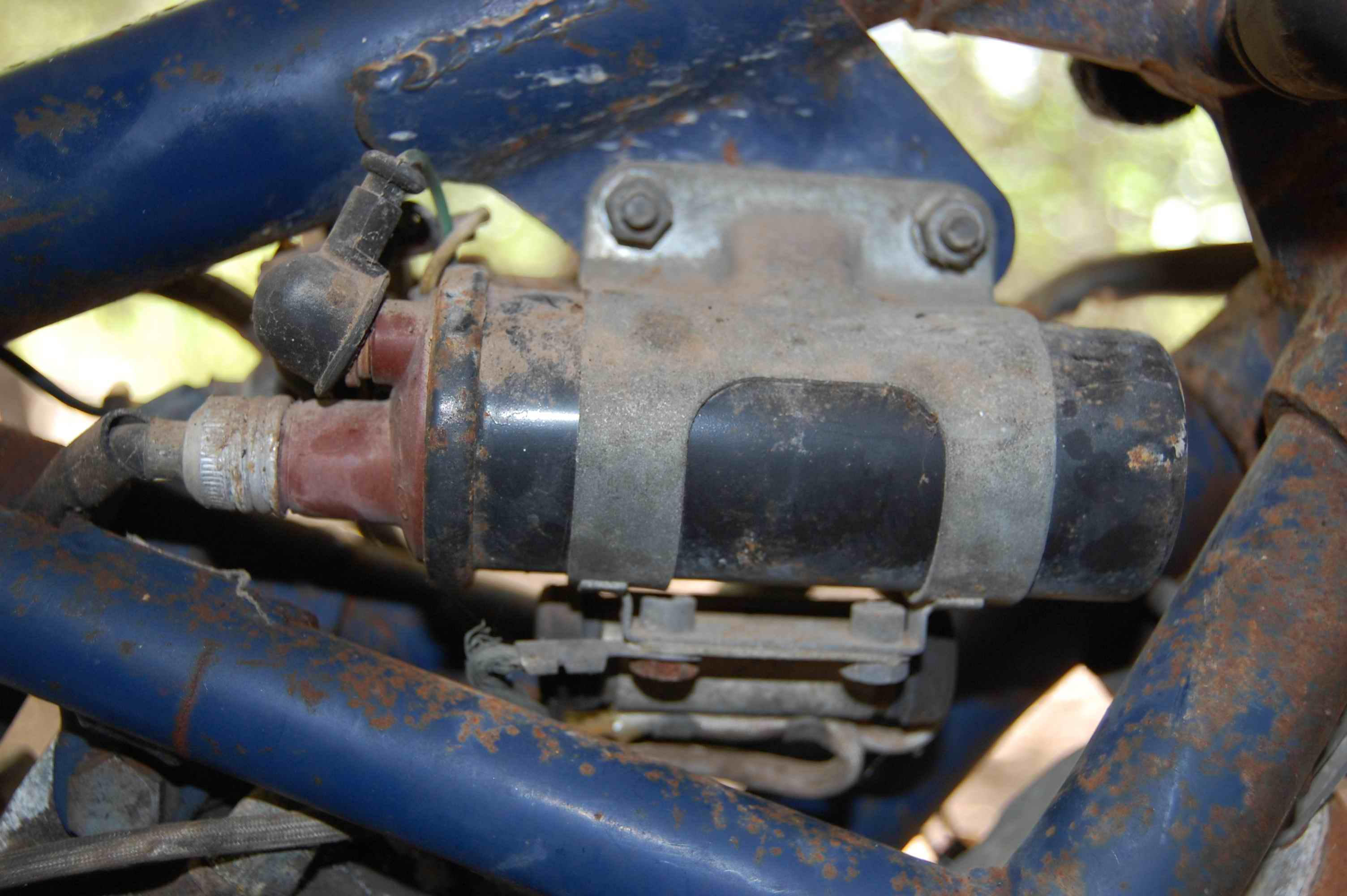

Post by 68Cb77 » Fri Mar 05, 2010 11:24 pm
here's a pic from a couple of years ago from my tear-down, Hope it helps

Sorry - I meant the short green lead that goes to the coil (-) won't reach if the condenser is mounted with the wires directed away from the coil terminals... Thanks for the pic 68Cb77 - That looks like how it probably should be. Were the HT leads outside the frame rails?

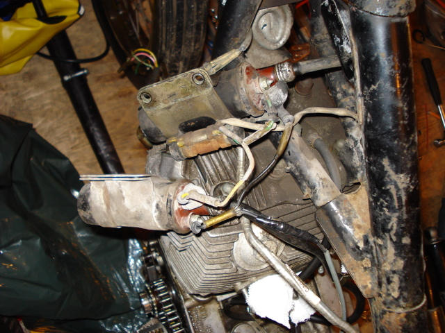

Post by jleewebb » Sat Mar 06, 2010 9:26 am
Here's a pic from my teardown...not saying this is correct, just the way mine was when it came out of the barn...hope this helps...Lee
note spark plug wires and ground strap running inside frame rails
