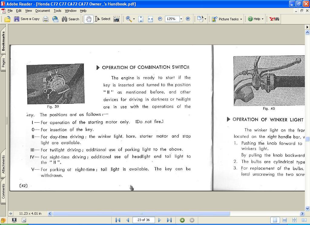

Post by brewsky » Tue May 07, 2013 6:08 am
There were at least 2 different switches used, 5 and 6 position versions.
Here's the 6 pos. instructions:
The 5 position eliminated the "twilight" position, I believe.

Brewsky....where did you find this info??
Post by Debsell » Wed May 08, 2013 2:03 pm
It looks like a book I would like to have !!
Thanks!
