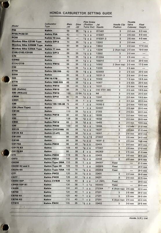

First I would try installing a pair of #140 main jets. This is a small bump from the stock #135s and will have most effect when the throttles are more than about 1/2 open. If this doesn't fix the problem I would raise the needles one notch. I have attached a file and linked to another with information that may be helpful.
https://drive.google.com/file/d/1nEnTN9 ... sp=sharing
