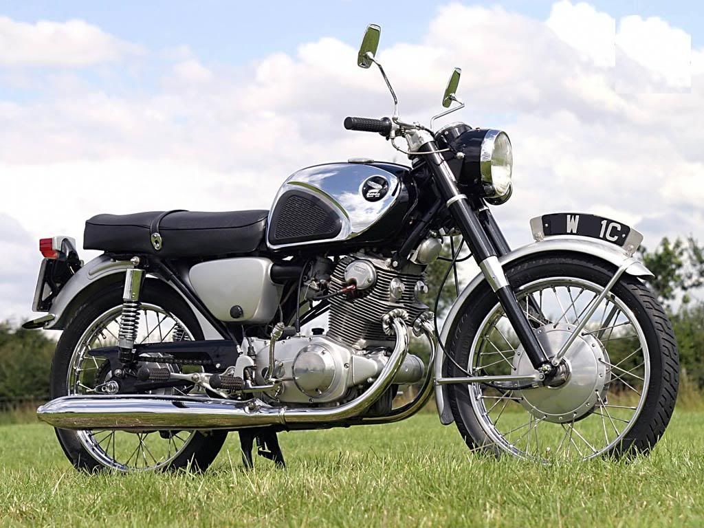

I came across some Avon Roadrunners in 90/90 18" & 100/90 18" from Tires Unlimited.
If one were to put the Avon AM26 RoadRiders on the stock rims, would it be better to get the 90/90 front and the spec 90/90 on the rear, or try and increase the size proportionately to 100/90.
Front: 90/90 Rear: 90/90? or
Front: 90/90 Rear: 100/90?
It appears to be what's on the Superhawk that I attached a little higher up.
