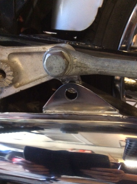

Yesterday, I received new mufflers for my CB77 from David Silvers Spares. In attempting to install them today, I am running into problems and I hope that members here can advise me.
Simply put, the mufflers just don't align with the mounting brackets. I believe that the bottom bracket is about an eighth of an inch out of alignment and if I do get a bolt through, the rear bracket and mounting hole are way off. It might be possible to enlarge the slotted holes on the bottom bracket and maybe bend them out a bit to make it work, but I'm not overly confident that it will.

Thank you, HN. Mr. Silver says that he does not use the upper rear mount at all, just the front and underside . I'll have to see if I can make it work that way.Hamamatsu Nippon wrote:According to Mr. Honda Bill Silver, the David Silver Spares mufflers are not a perfect fit. He addresses this in his ebay auction in the questions portion .
http://www.ebay.com/itm/262369425704?_t ... EBIDX%3AIT

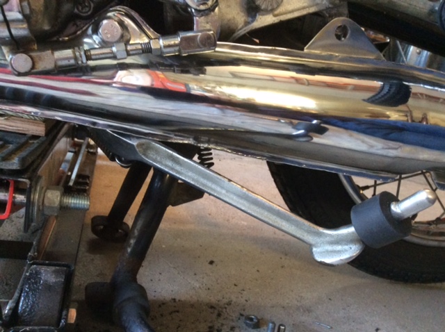

Well, I tried Mr. Silver's mounting method, using just the forward and mid mounting points. It attached without too much trouble, but the side stand jammed against the bottom of the muffler at about two thirds of the way up. No room for adjustment.
I reinstalled my old muffler, which took minutes. Now I guess I'll have to return the two I bought from DSS. Wish me luck with that.

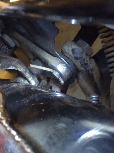

I'm really glad I had the left muffler off though because I got a look at the side stand bracket. From my research of the side stand topic on this forum, it appears to be a Honda item, but the main stand mounting bolt was never changed to the longer part number 90146-268-810. Whoever installed the side stand put a cotter pin through the end of the short original bolt. No nut. Not good. I'm wondering if this is at least part of the reason that the side stand tips the bike too far over, although there is slop in the stand's pivot bolt. I'll need to remove it for a better look, but I need to find the longer mounting bolt & nut first.
