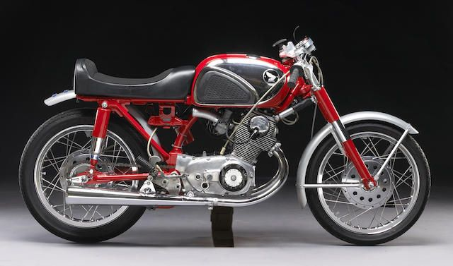

Looks very close to your CB77!!!
honda cyb77.png (286.12 KiB) Viewed 8707 times
