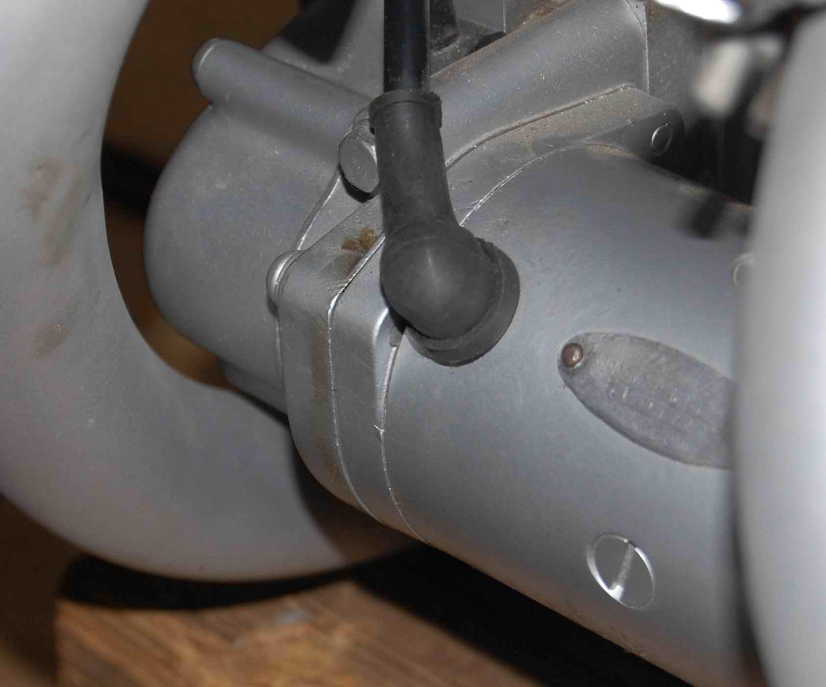

new starter terminal boot available from Ohio Cycle. I'll get you part no.
Looks like you'll be riding pretty soon, looking forward to hearing (and seeing) all about it. --Lee

starter boot
Ohio cycle starter terminal boot is part # 32411 253 000.
So where you at? Regards, Lee

Re: starter boot
Lee, thanks for that. I'll certainly give them a call. Its a shame their ordering process is such a pain. Must have never heard of PayPal ; ) I'm from San Francisco, sitting out this summer in Sacramento then back to the bay.
