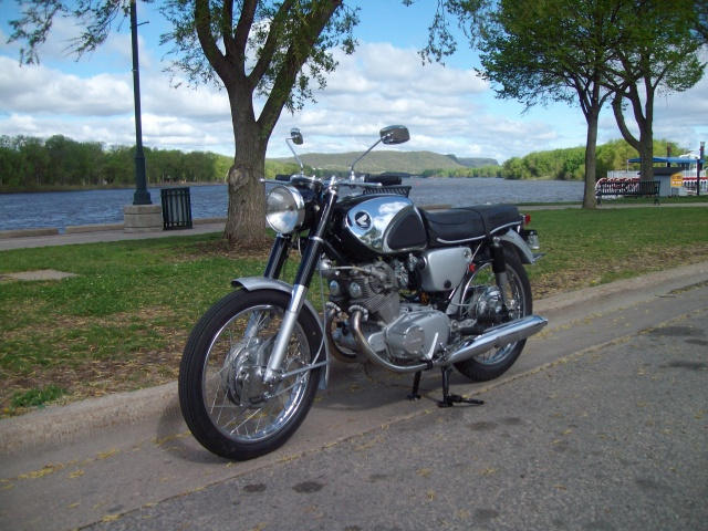

FUN
It was a cool but sunny morning, about mid 40s. I gave it about half choke and it fired right up. My Son wanted a ride, but I wanted to give it a test ride around the block to make sure everything was working. I rolled down the drive then down the street. The baffle-less pipes roared as I opened it up. This was too fun so when I got to the corner and kept going. It ran so well, I ended up giving it a ride around town! If I had to sum it up in one word, it would be FUN.
I stopped back at the house and he was waiting with the camera. He hopped on the back and we went to a local bar and eating place for breakfast. We parked next to the Harley's :) The Super Hawk rides well with a rider.
After breakfast we drove down to the park along the Mississippi for a picture, then to my Brothers House. He hasn't seen the bike since we rolled it out of his garage last fall and loaded into my pickup truck. He was in the yard and had a big smile on his face when we rolled in. He took it for a ride. I didn't think he was coming back. We made a few more stops on our way home.
The bike runs great and it FUN to ride! Here is a few pictures from it's maiden trip.
