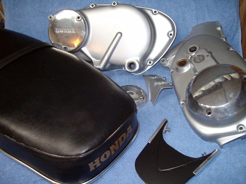

An update. Here is a pic of some of the things I have been working on. The seat I posted on earlier, I removed the cover, repaired the foam and made a strap. The motor side covers were cleaned up and painted. the small covers were polished. The motor will be bare aluminum and I have about half of it cleaned.
The rear mud flap and stayes are fabricated and I just finished this. I am also repairing one foot peg bracket that was cracked and broke. I have been trying to get one on ebay, but they are going for more then I want to pay. If I can't get one for a reasonable price, I think my repair will be strong and not noticeable.
The oil plug was stripped, so I put in a helicoil and picked up a new plug from an auto parts store. I also broke two bolts taking the oil pump out. I had problems removing the bolt, so I had to drill them out and repaired the thread. With the motor on the bench, it made it easier to repair these threads.
Next it's finish the motor cleaning and put it back together. The frame and wheels are next. The tank and fenders are still waiting for paint.

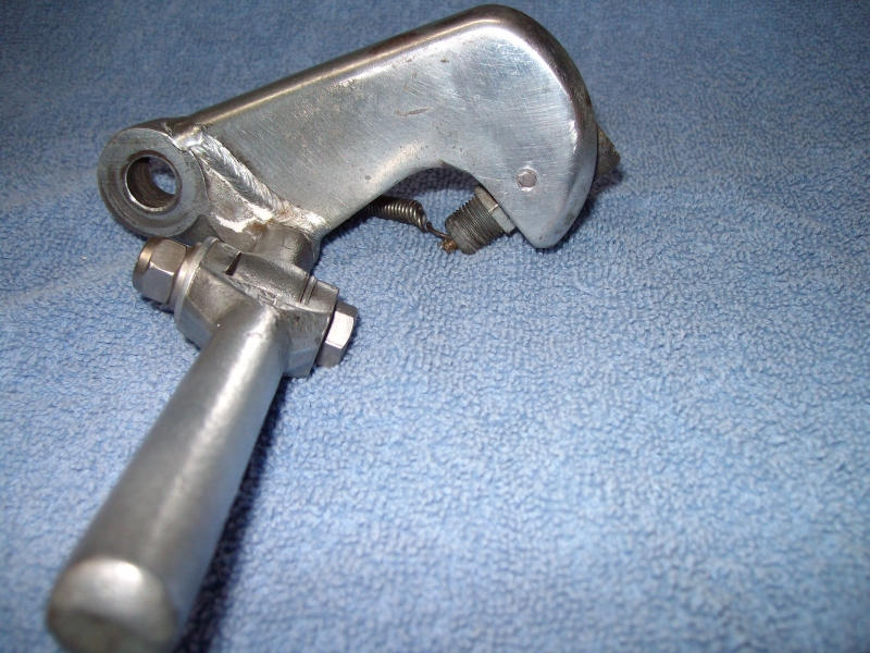

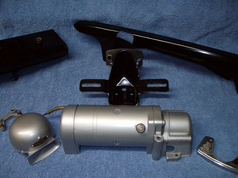

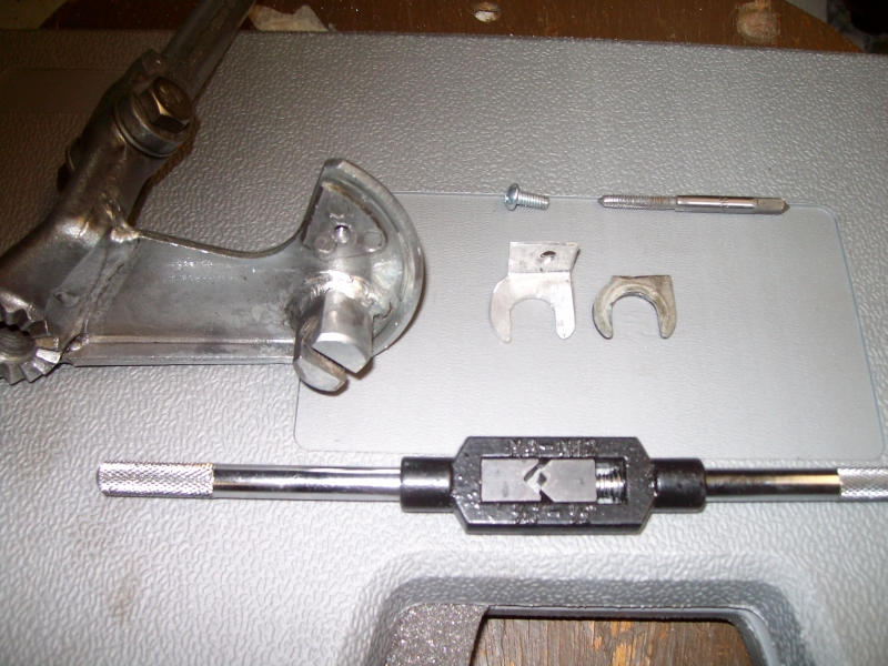

Here are more finished parts. Lots of cleaning, painting and polishing. The second picture is my foot peg bracket repair. I ground a slot in the bracket and made an aluminum brisket and put it together with JB weld. Then I formed and drilled an aluminum plate to fit the shape. I cut two 12MM bolts and used the back of the threaded foot peg holes. I drilled and tapped one smaller bolt in the center. I coated this with JB Weld and bolted it on. I touched up the exposed JB weld with a little paint on a Q-tip. I will just use the center hole for the back foot pegs so there is no strain on the repair.

Post by Spargett » Wed Jan 07, 2009 2:23 am
The starter painting looks great. I just pulled mine off. I'm sanding it down as best I can before a much, much needed painting along with the covers and few other parts.
You can see a nice pit of rust under where some sort of badge use to be.

It looks like your about ready for some paint. I didn't have a badge on my starter.
Just make sure you get your insulators in the right place when you put the nuts back on the electrical terminal. They insulate the bolt from touching the case.
