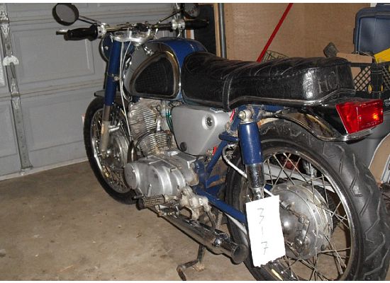

my 68 superhawk..
its gettin better every day. wish i had more time and money to work on it and with. i really want to get the engine sandblasted. someone had the great idea of spraypainting it back in the 80s. now its nasty. no amount of scrubbing can fix this..

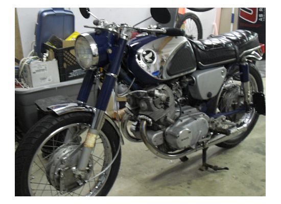

ive had to crop the hell out of these. but you get the idea. i was looking at seats for my hawk. but i dont want to order anything from tialand. japan hell yes. but no tailand. does anyone know a good ebay dealer with some reproduction seats. or mabey i'll get the cafe seat i was looking at. o yeah thats a taillight from a yamaha and rear fender from a honda something.

Welcome to late CB77 seat-hell. Read previous posts.
Any good paint stripper will remove the clear coat, just be sure to wear gloves and ventilate ... the stuff is nasty (Methylene Chloride), a known carcinogen, and absorbs through the skin. Then the exposed Aluminum will start to oxidize immediately, so throw some car wax or something after you polish, or rattle-can clear-coat is you want. I used steel wool and lacquer thinner to remove the old yellow coating, but I probably shouldn't have. Steel (even #0000 steel wool) gouges the soft Aluminum and leaves swirl marks (which can be buffed out), but I'm not going for the show look.
Lots of threads here on that stuff.
