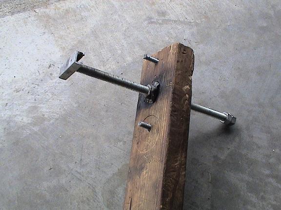

Post by brewsky » Wed Jan 18, 2017 6:18 am
This cylinder and intake port were both full of rust, and soaking and a hammer was futile.
So I filled it full of atf/acetone mix, heated and cranked it down as much as I dared each day, and left it under pressure.
After a couple weeks I heard a loud BANG as I walked away....thought the wood had shattered, but the piston had popped loose!
