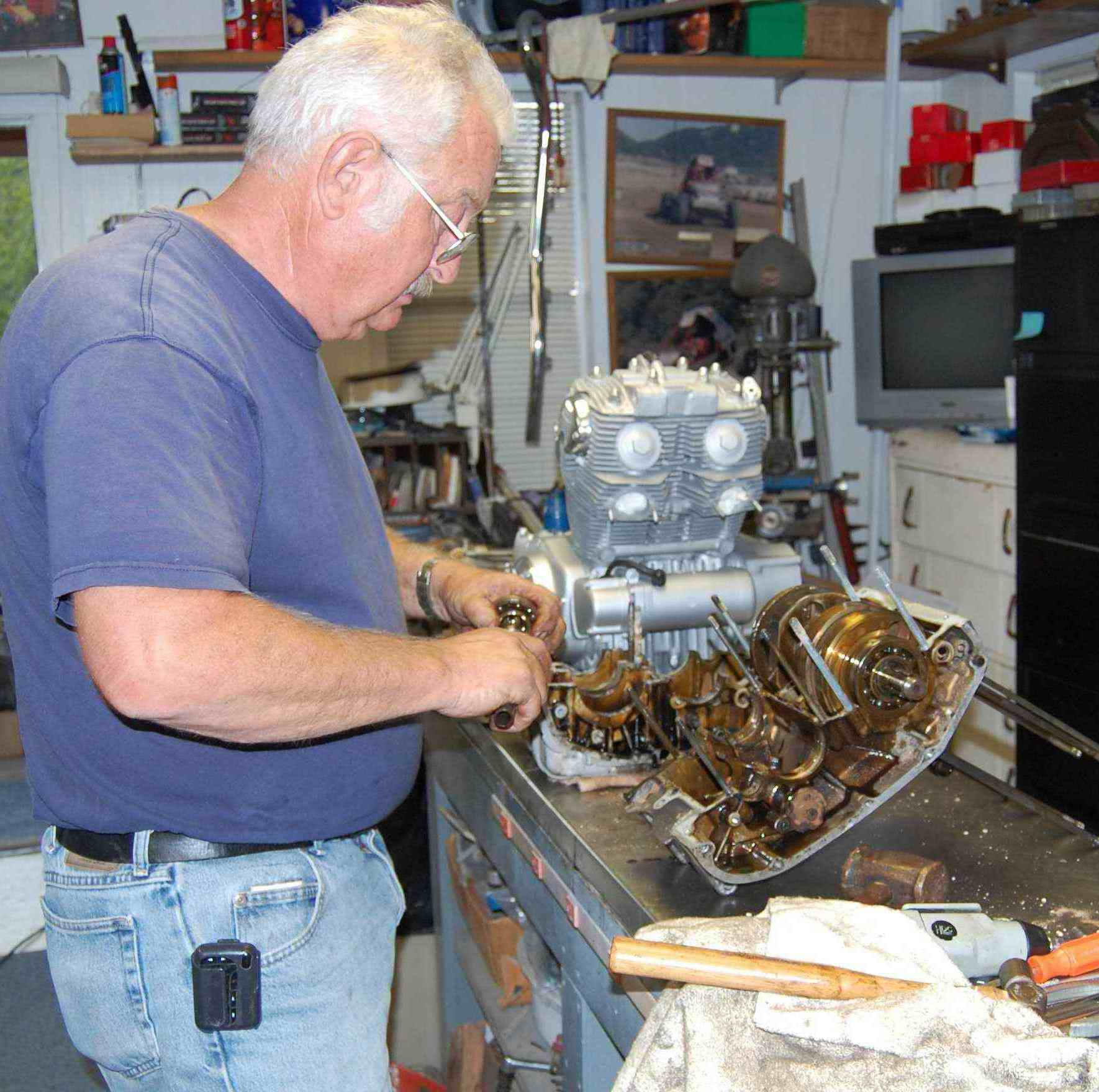

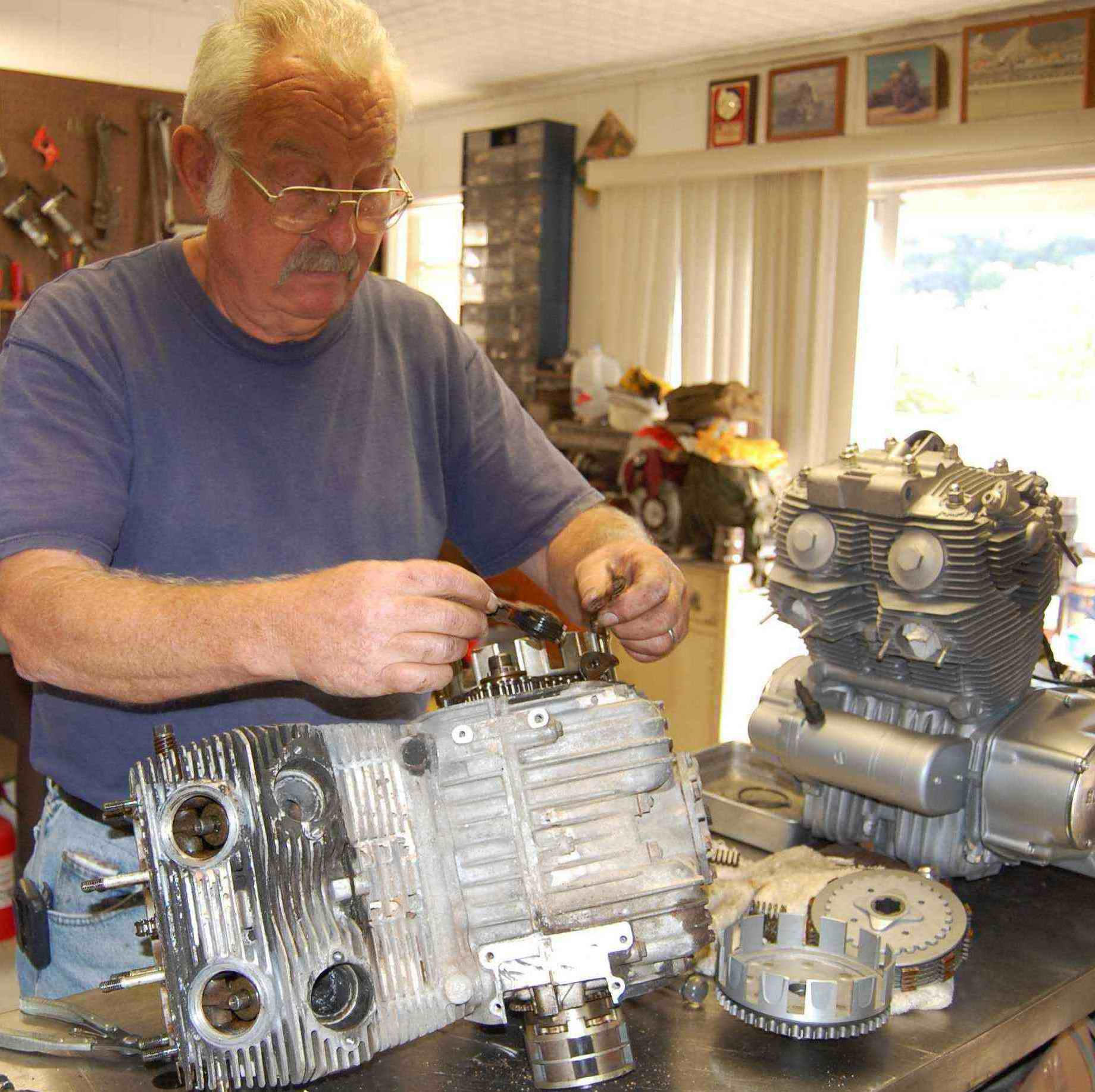

I thought I was just delivering the engine to get in line for rebuild, but once we got it on the bench, Ed tore right into it. After about fifteen minutes he already had the top and side covers off and it occurred to me to go get the camera. First pic below (assuming I remember to load them in first pic last) was taken at 3:41 p.m. Last pic in series was at 4:57, with engine and transmission basically dismantled. Ed just worked along steadily, inspecting parts as he went, separating good from possibly good from bad with a running stream of explanation and commentary. Trying to absorb all he was telling us was like getting a drink out of fire hose, but I think I got the general idea and I’m trusting Ed to keep track of the details.

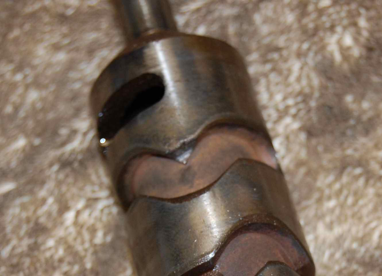

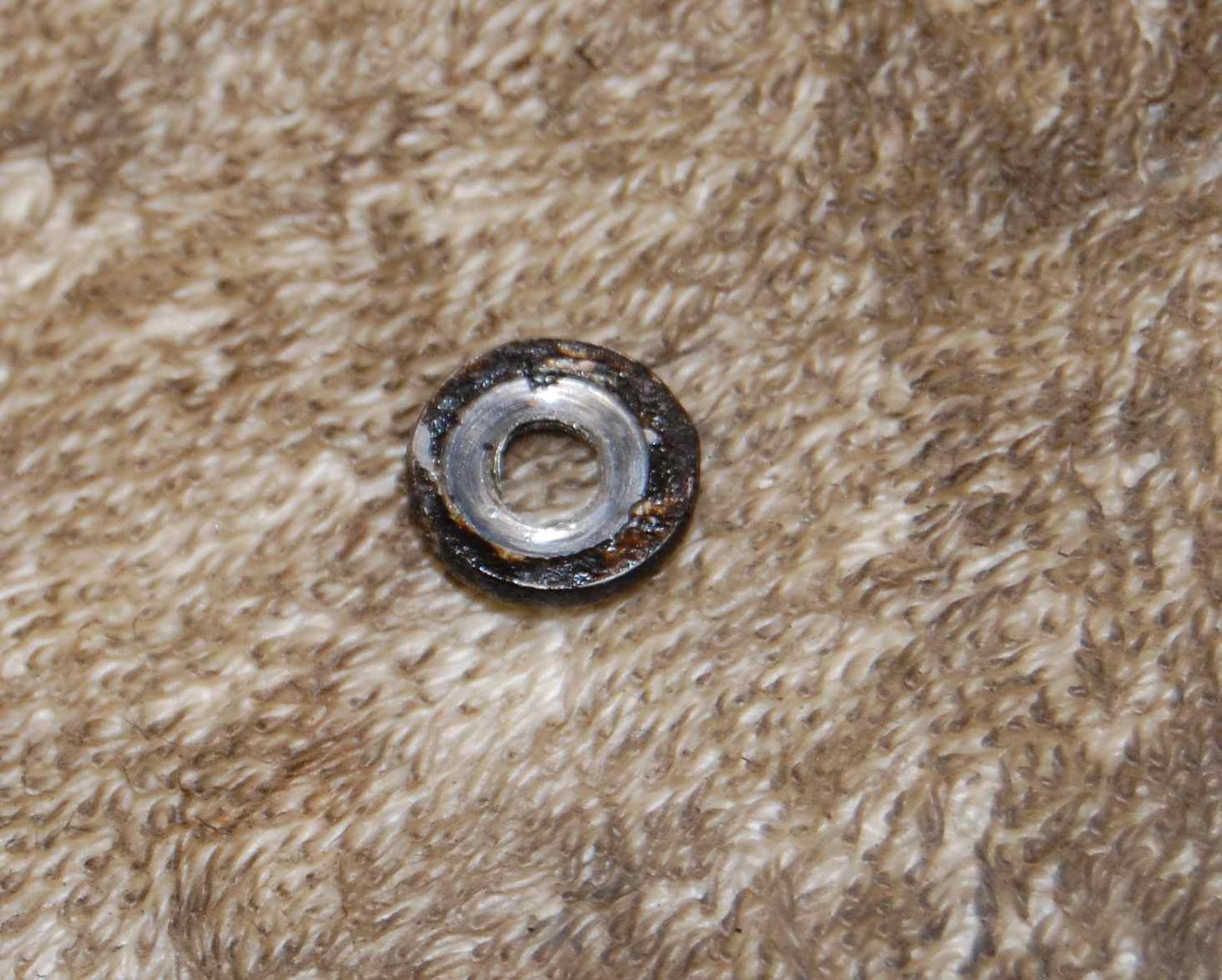

Bike had a major shifting problem when it went into the shed in ’75, and Ed found the problem right away, and uncovered a mystery. The shifter drum was in the worst shape he’d ever seen one, he said, but the gears and most other transmission parts were in great shape. “No way these gears have 20,000 miles on them, somebody’s been in here working but they didn’t replace the right parts.” I gotta believe it, but I sure don’t remember having any work done on the transmission. What I do remember is trying and failing to free up stuck clutch by speed shifting and otherwise abusing things. I finally pulled cover and freed up clutch by prying plates apart with a screwdriver, but it never shifted right after that, finally wouldn’t go to second at all. Ed says it needs a new shifter drum and a shifter fork, which he has. He’s also “x-ing the gears” which finally makes sense to me now that I understand “x-ing” means “crossing.” Sounds like a good idea to me.

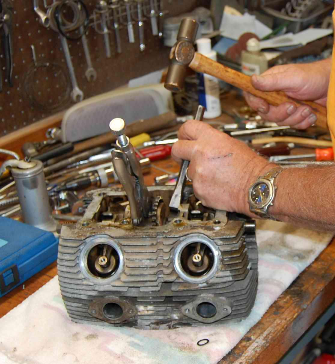

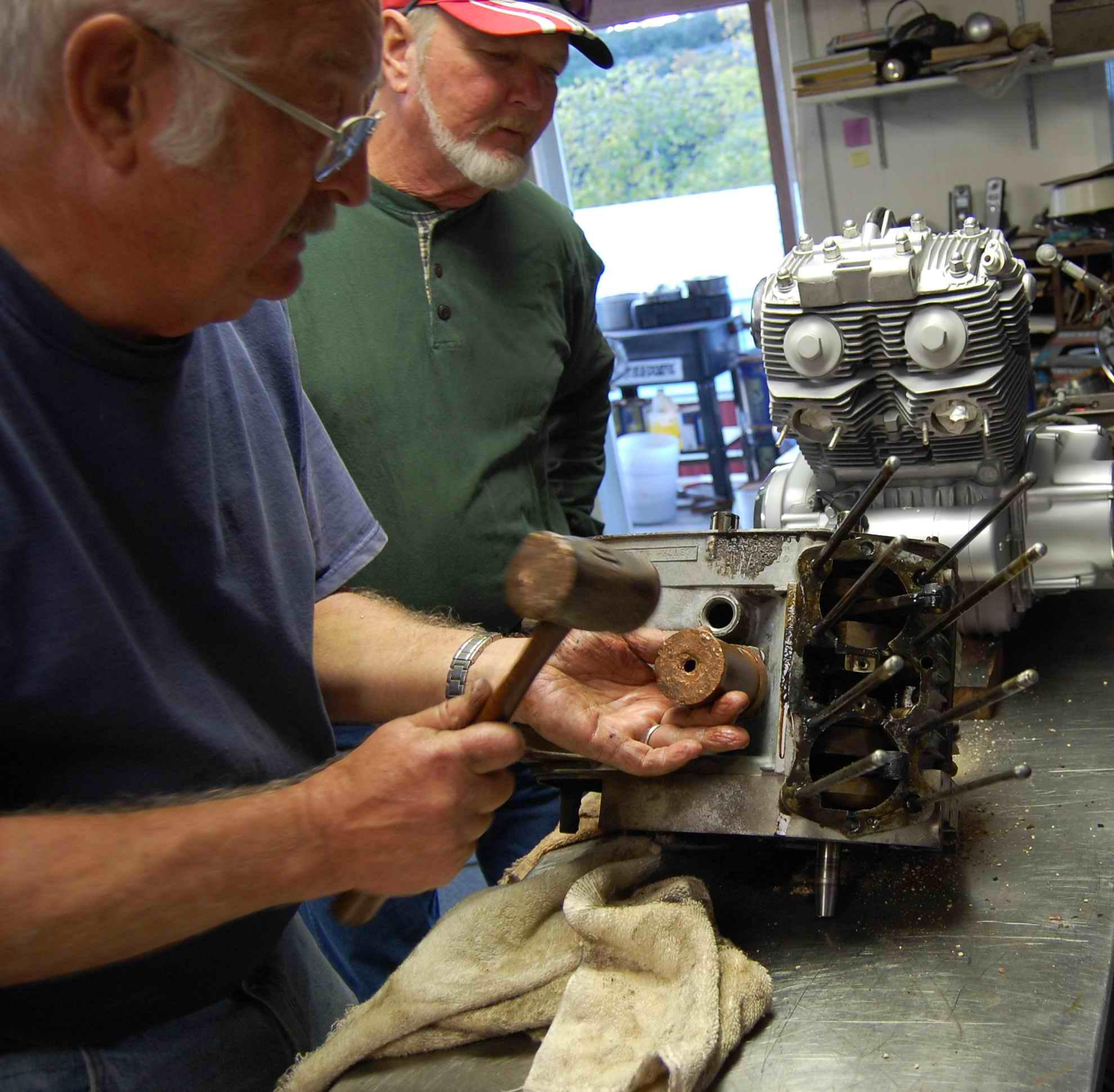

Ed pulled the camshaft and valves in nothing flat and after sandblasting and turning valves and other parts pronounced most of it good. Let me try and get this story straight: As Ed’s loosening up the cam locking nut that holds shafts together he says, “you know, (noted repair guide author) will tell you that this nut is always left hand thread, but here this one’s right hand thread. Only the second one I’ve seen like that.” Very interesting, little details like that

Note he's knocking it "lefty-loosey"
Charlie's "helping"
Charlie's "helping"
No wonder bike didn't shift too good.
Pretty much apart before 5 p.m.
Ed began taking apart around 3:15.

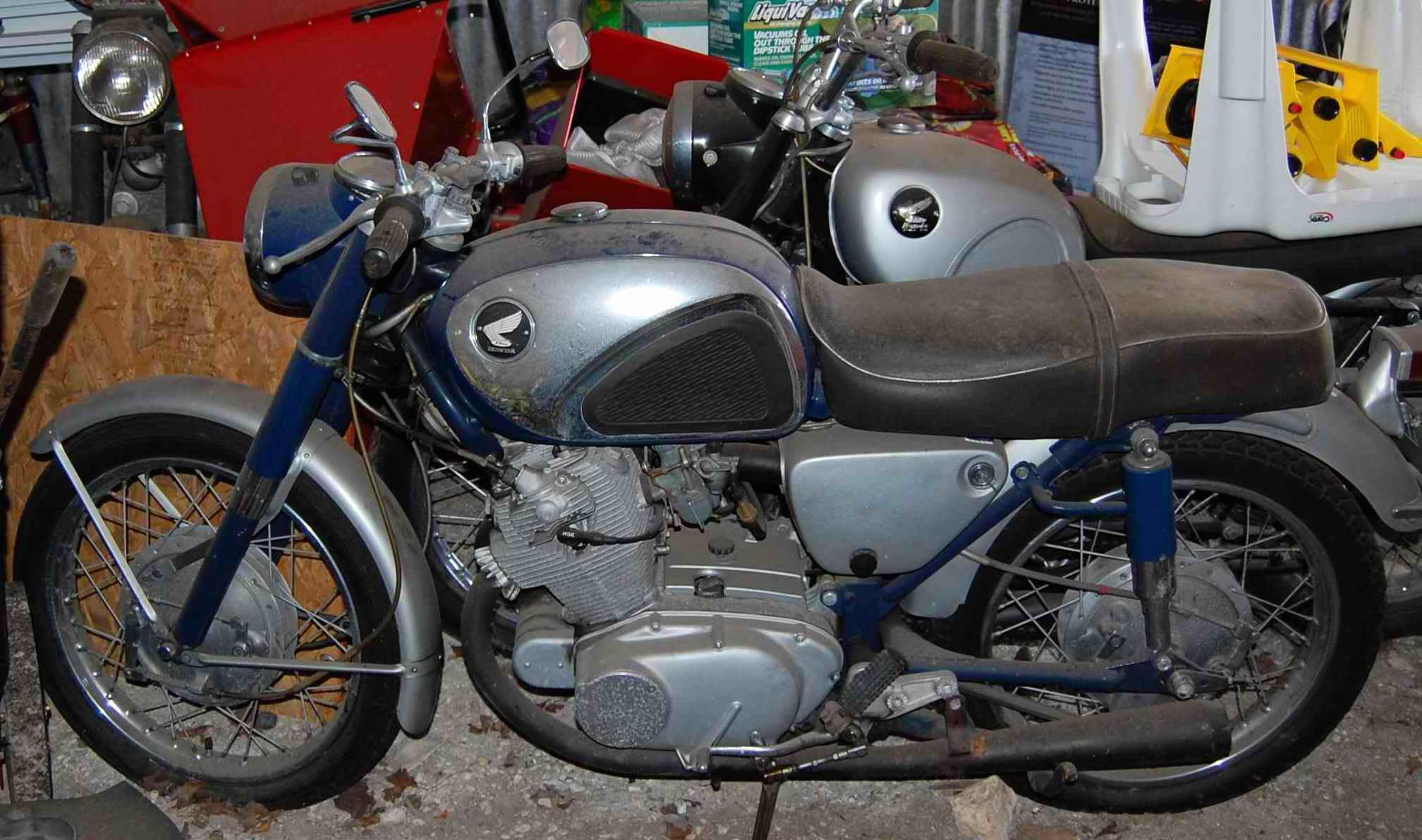

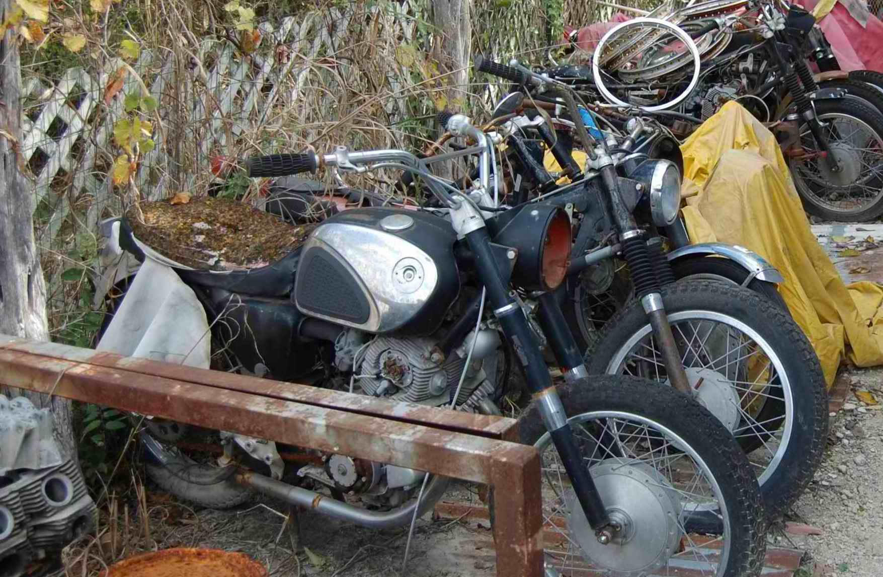

Needs riding, Ed.
Needs riding, Ed.

Well I was all happy to see this post till I saw the "boneyard" and realized LM's junk is better than some of the daily riders I've seen pictured on this forum. LOL
