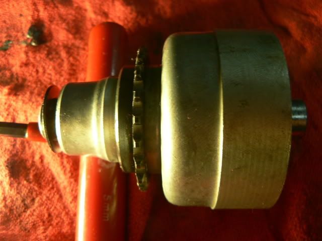

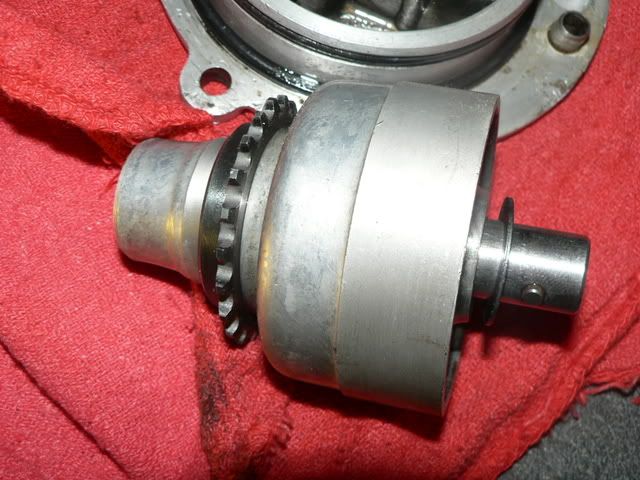

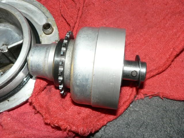

ok so i said it., it doesnt take much to confuse me sometimes. I pulled my 65 cb77 apart to clean the oil filter. I pulled the small cover off first and then the hole side cover. To my suprise there was no washer on the filter at all, but i did find it at the bottom of the case just laying loose. I have read where the washer goes but i am still a bit confused. I am just going to post some pics and see if someone would be kind enough to tell me which is the correct way,..

Post by AWILLIAMS64 » Sun Mar 01, 2009 7:28 pm
i believe the middle picture is correct but i just want to make sure before i put it back together.

Post by Gunner_CAF » Sun Mar 01, 2009 7:43 pm
Yep, the middle picture. If you put the shaft into the hole in the cover, you will see the washer will be between the cover and the filter. Check out this thread, I have a picture showing this:
