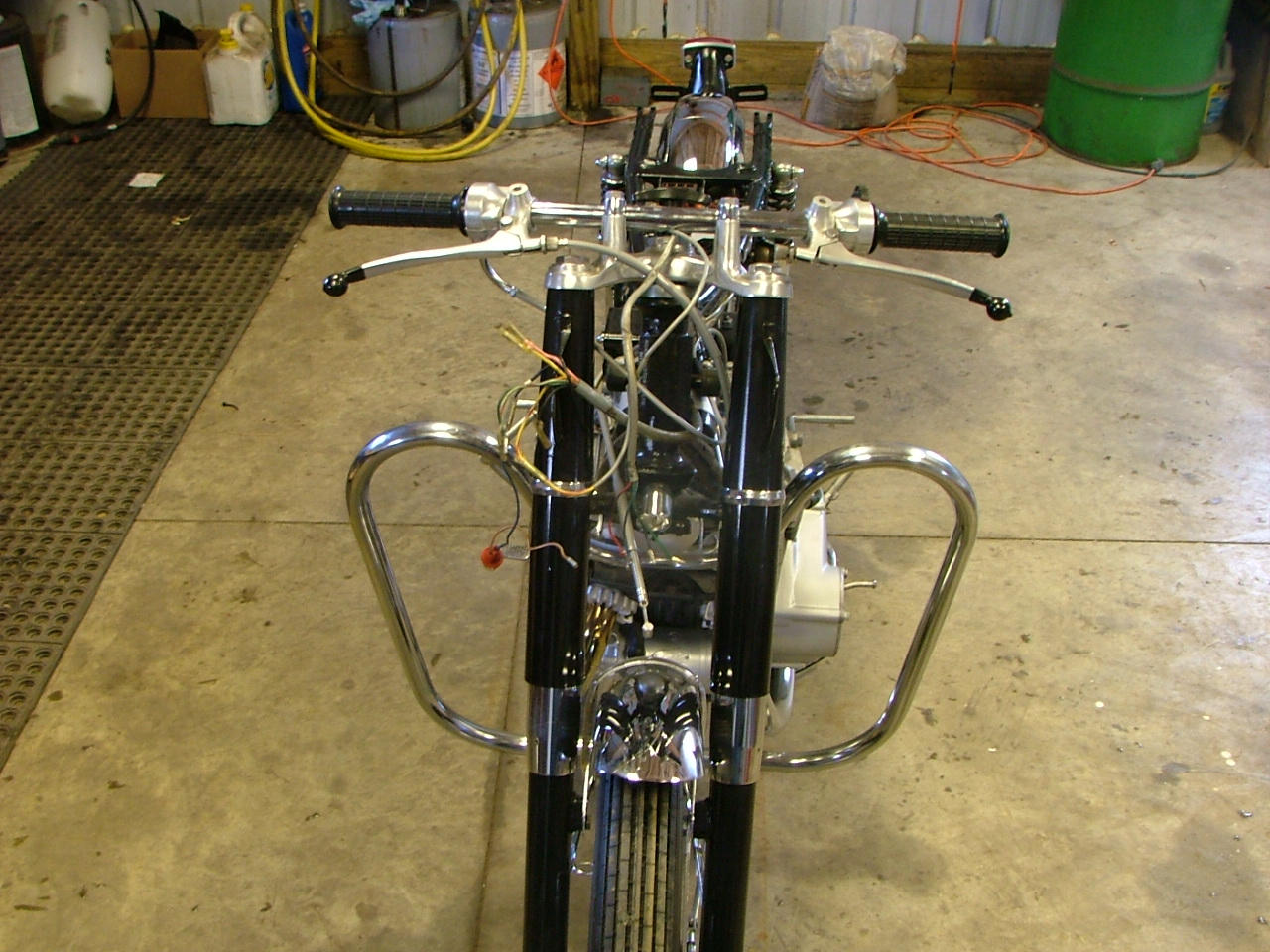

Well I got the same bars and just went for it free hand. I centered the bars and set the angle and drilled the center hole. After I drilled the hole I run the bit in at an angle and ovaled the hole slightly to leave a non- sharp edge,and also made it easier to feed the wires through. Then I mounted the handle clamps even and marked for the switch and throttle bracket wires. Then cut the ends last. I remember it being around an inch maybe alittle more cut off each side. Sorry I dont have the exact measurements your looking for. I quess I winged it. Good Luck !!
