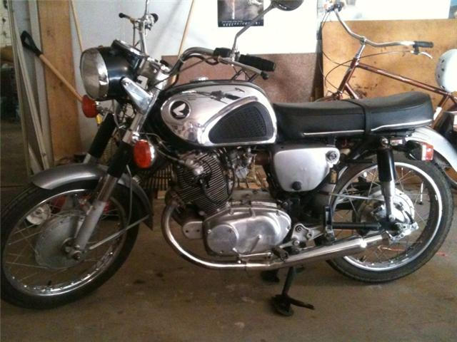

My clutch cable broke on the weekend. The tab that holds it to the lever came off.
I figured now is a good time to switch to low bars. But am having some trouble finding the correct cable number.
This is the number it shows...22870-281-000, I'm thinking this is for intermediate bars. (which I have now)
Would this be the correct new number 22870-268-010??????????????
Any help would be appreciated.
Thanks
-RYAN
I've attached an old picture, with the OLD bars!!
serial number....CP1000077, CP77E1000074
