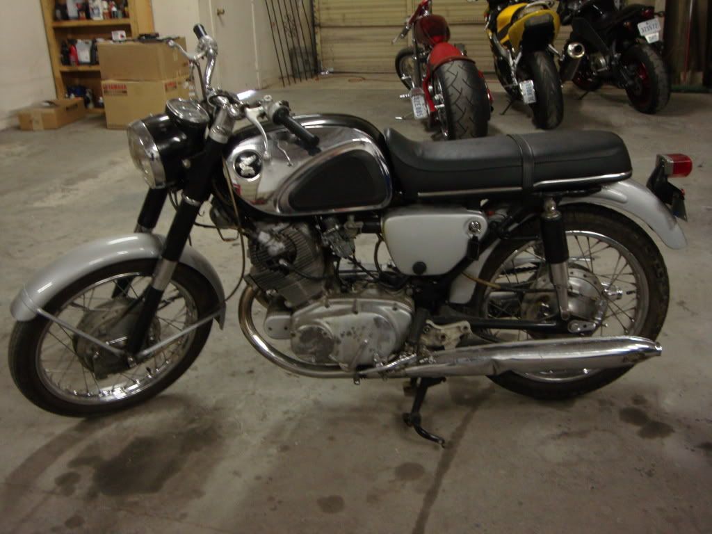

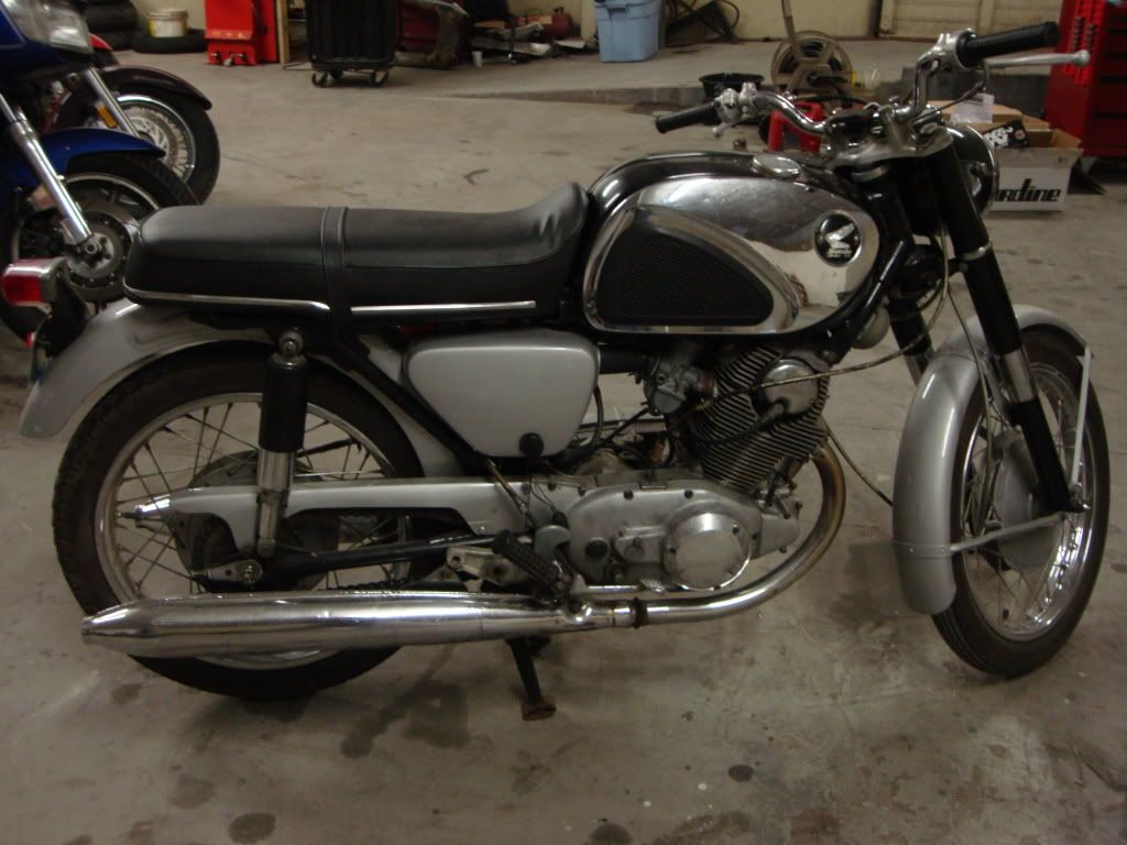

I have a '64 CB77 that im doing a resto on and would like to get some info on rebuilding the front end. It had a real bad squeek in it and i pulled the forks, turned them upside down and they were bone dry. My question is how much fork oil is supposed to go into each fork? Also i have been ordering parts from http://classichondarestoration.com and they show fork seals for early and late CB77's. What is a 64 considered? Thanks in advance and here are some pics of it. So far ive rebuilt both carbs, rebuilt the petcock, performed a valve adjustment on it and changed out all the cables(all of it done after pics were taken)
