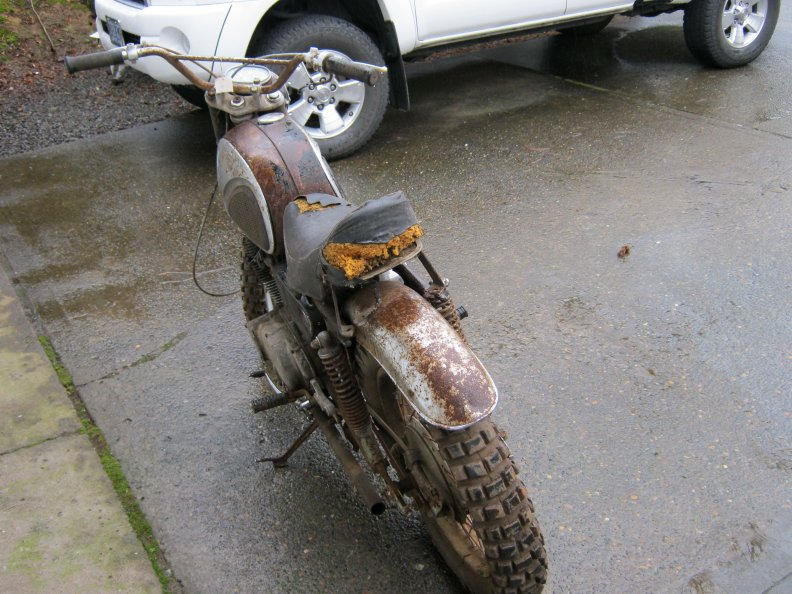

Bought this POS 7 yrs ago and just brought it out of storage. It rolls through with compression so it should run, we'll find out shortly. Tank had a gallon of foul smelling bad gas from probably 30+ yrs ago and I must have dumped out 2lbs of rust. If it runs out okay maybe it should be my new "ratbike", I'll throw some parts at it to make it street legal.

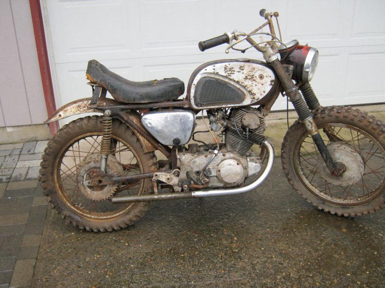

Saturday I dropped the engine down pivoting on the lower rear mounts, pulled the head cover and moved the cam timing one link. Adjusting bolt broke off the cam chain adjuster so I replaced the whole unit. I didn't realize the left cam had been replaced with a CL unit until now. Replaced the carbs with the round bowl PW22's. Changed out the cut off peg mounts, dug out a set of CB header pipes that had been extended (I can never seem to throw anything out!) welded some brackets on and mounted them to the footpeg brackets. Found a seat that really fits well with the "ratbike" theme of this bike. The moment of truth is about to happen: http://www.youtube.com/watch?v=FGKrSZa3 ... e=youtu.be

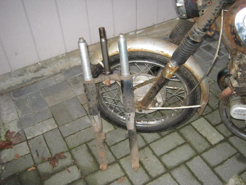

When I bought this "thing" I had one goal in mind and that was to make and hear it run. Now that that has been accomplished, it changed to make it a riding ratbike. Now that has changed some. I keep throwing parts at it. Though nowhere near correct it is slowly looking more like a Hawk.
It now has fenders, nice wheels, decent tires, wiring harness, starter solenoid, chain guard, centerstand, and will soon have a different set of forks. Still not sure what direction I'm going but I'm having fun!
