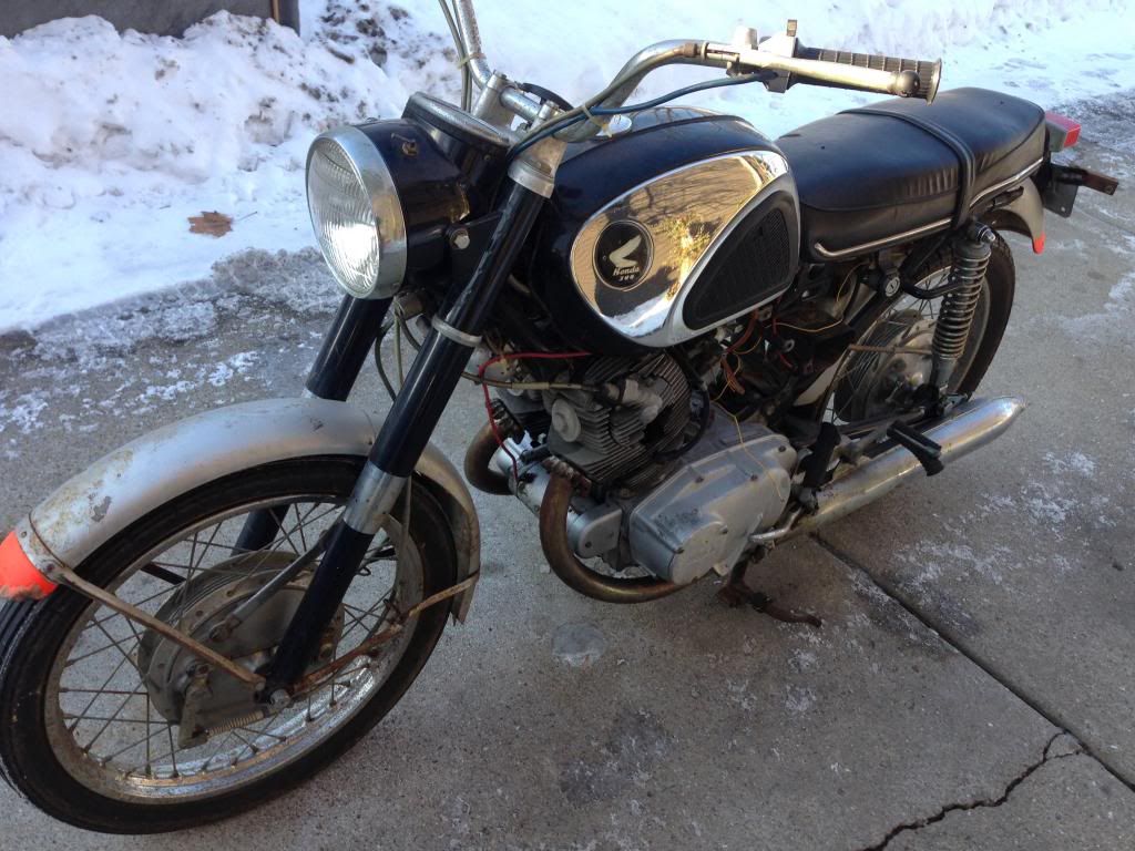

Here's the bike-it is in quite good original shape. It was sold to me cheap, with the warning that the engine was stuck. removing the side cover revealed that the kickstart mechanism was what was locking the engine-it turned freely after sorting that out. I've spent a lifetime working on British bikes, and this is the first Japanese bike I've ever owned-it called out to me to rescue it from being turned into a bobber or cafe racer, which is what some young guy in the family wanted to do,before he realized that it might be too much of a project for him. All the side covers and other parts were in a milk crate that came with the bike

Great looking project. Pull off the gas tank and look for a white tag on the wiring harness. This will have a date on it which will be the date of manufacture of the loom.
If you are going to run the bike, it's a good idea to clean out the centrifugal oil filter, underneath the left cover. These often get neglected and get packed solid with sludge.

I got the wiring harness out from the box of parts I took off the bike-it has a date of 1965 on the Sumitomo tag.
