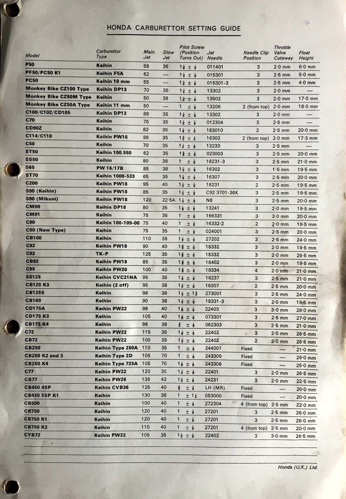

- Settings small.jpg (279.84 KiB) Viewed 2703 times

I set all the carbs I rebuild for members at 135 and 42. ..................lm
