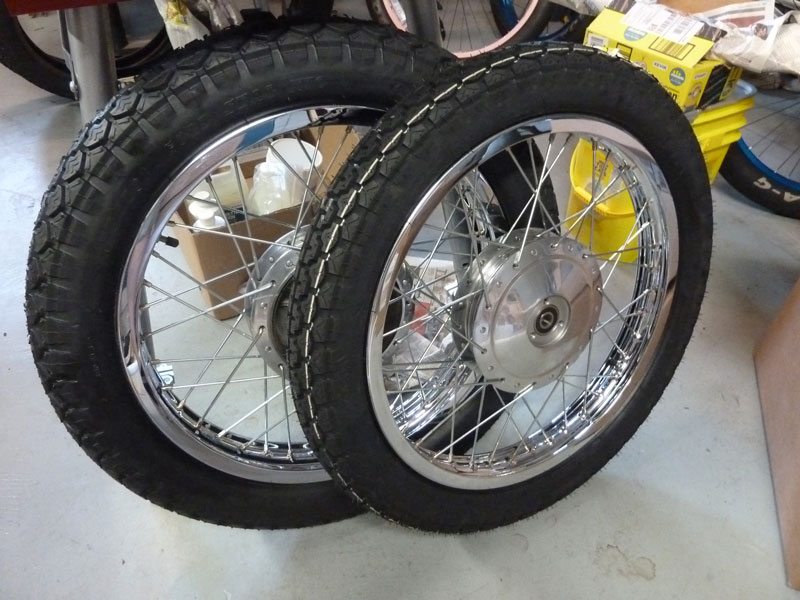

Post by tdboze » Sun Jun 11, 2017 2:45 pm
Thanks malcomgb. Everything seems to be going smoothly. I am now entering final assembly, but just bought a house and am going all out trying to get it ready to move into and the old one ready to sell, so once again the CL waits...
I did get the rims reassembled and K-70's mounted. Had the spokes and nipples re-plated. In hindsight it probably would have been better, easier and probably cheaper to go through Buchannan's but it seems I've never been one to do things the easy way, and I'm trying to utilize as many original parts as possible.
I'm hoping once we get moved to have this baby together within a month. We'll see.

Post by HondaPaul » Wed Jul 19, 2017 12:01 pm
Don't you just love the look of these rims once you have fresh plating and rubber on them? Nice work!
