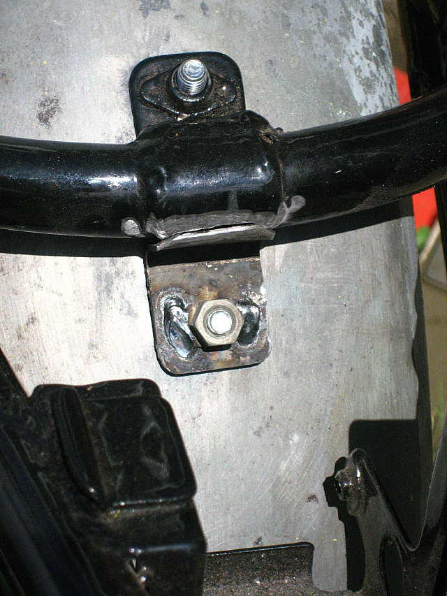

Post by G-Man » Sat Apr 04, 2009 4:52 pm
Superb photos - that explains it perfectly. Back in the UK now so I can get on with some fettling. Thanks for all the help so far.

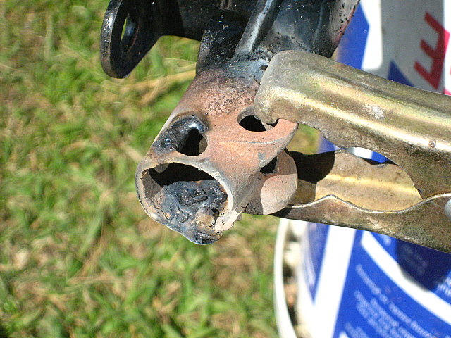

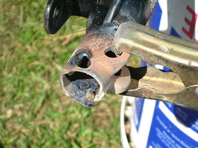

Post by G-Man » Sun May 10, 2009 9:07 am
My frame looks like it has had a hard life and at one time the grab rail has been welded on. Additional bolt holes have been drilled in the frame which combined with corrosion and a few cracks were not really helping the integrity of the rear end. In several places brackets have broken off, so I have been busy with the welder, making up parts and filling holes. The PO had powder-coated the frame on top of all sorts of mess so that is having to be stripped in the places I'm working. Only the stop-lamp bracket to be re-created and welded on now - should be ready for paint again soon.
Quite a mess to be re-constructed here
