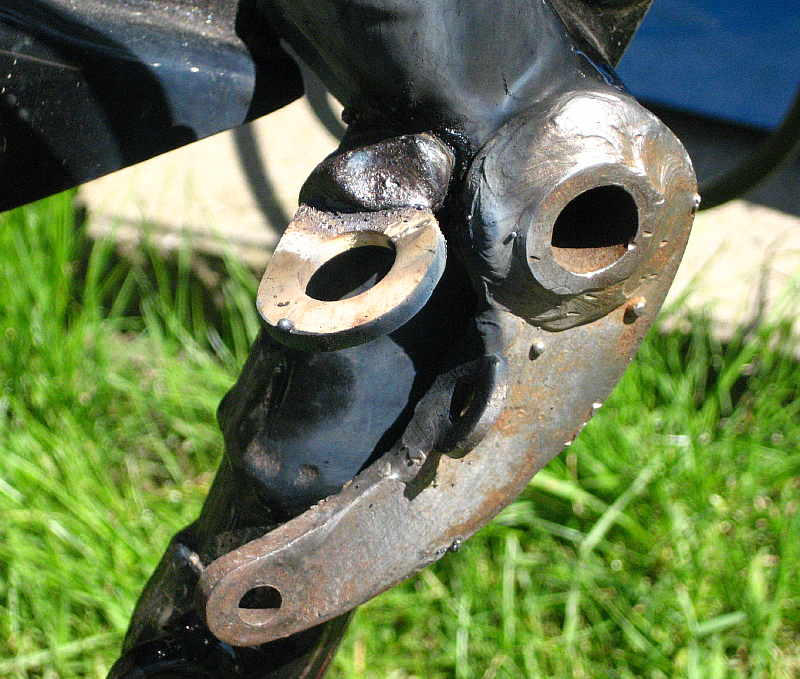

I am working on re-making an original stop light switch on my CL77. I have remade the frame bracket and welded it to the frame, destroying a little more of the PO's lovely powder coat in the process. I cannot locate an original CL77 switch, which from reading several posts here, I believe uses a spring to keep the plunger extended - contrary to the operation of most other switches which use the spring to retract the button.

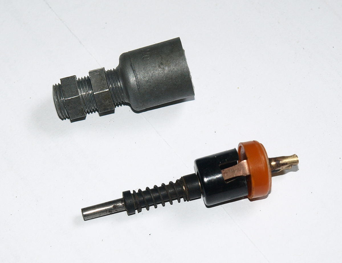

I have dismantled a CB77 (I think) switch by parting off the swaged end my lathe but cannot see an obvious way of reversing the operation without shorting the contacts out.

Stop switch bracket re-made and welded to frame
CB77 switch disassembled

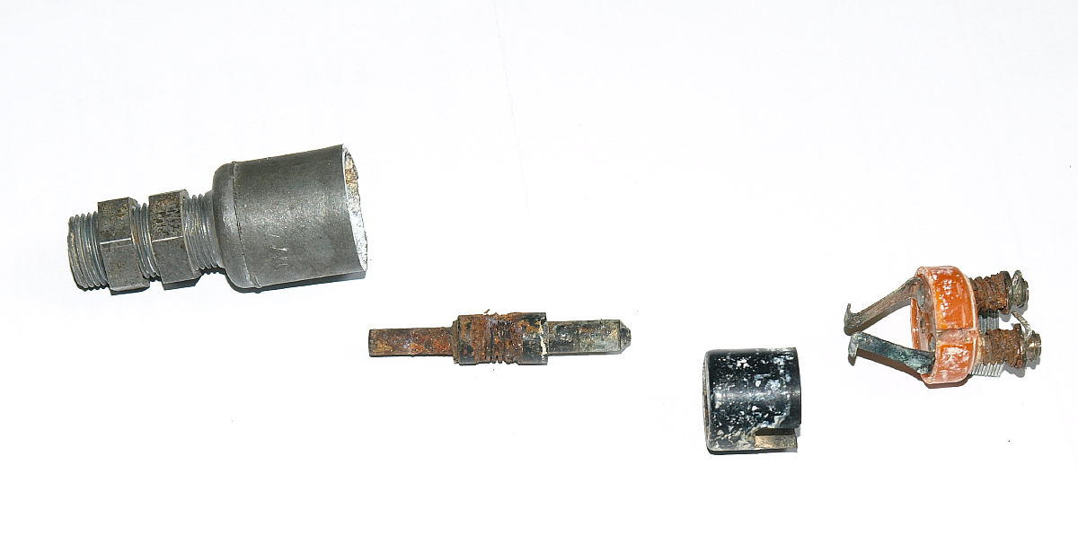

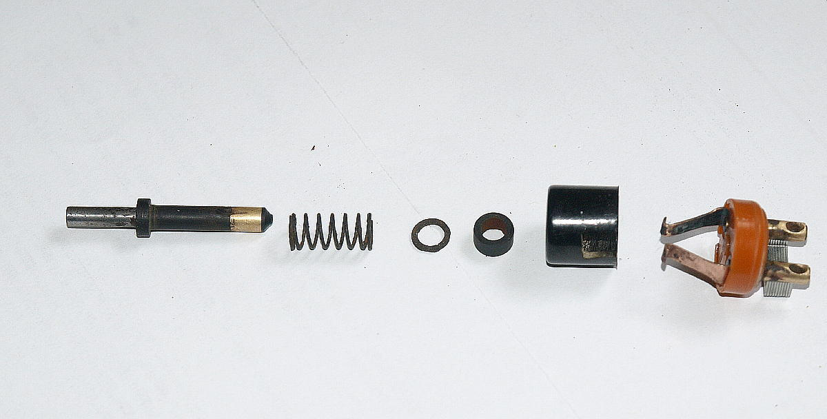

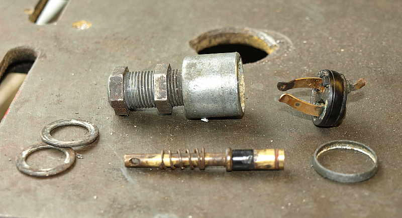

Well - here's what I found. A completely different design from the 'pull with a spring' switch but using the same basic body with a slightly different end cap. I parted off the swaged end of the switch in my lathe and there was no spring powered exodus of parts. Corrosion had tamed all that spring power!

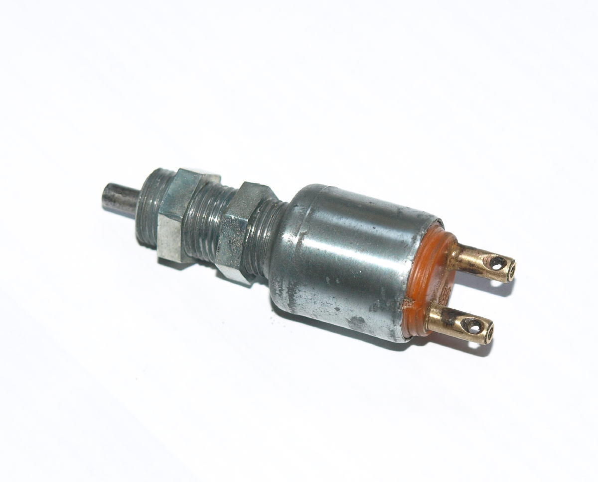

The spring on the plunger was completely seized and the springs for the contacts at the back end had completely disintegrated. I managed to clean up the plunger and the spring but my box of assorted springs has 'gone walkabout' so I cannot finish off the connections yet. The switch now moves smoothly in and out and the switch makes and breaks nicely.
This has been worth it for me for the education and your switch is alive again. Wins all round methinks!

Parts assembled in order
Parts cleaned up and laid out
Entrails exposed
Entrails exposed
Switch reassembled
Switch reassembled
