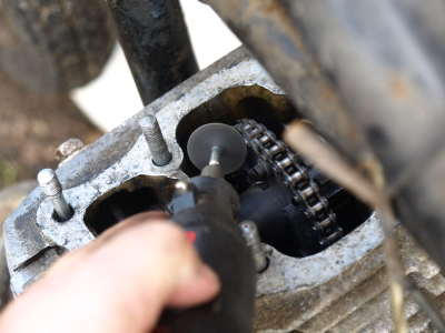

Finally got inside the CL72 motor. The pistons were stuck so I had to take my dremel grinder to the cam chain. With plenty of heat and some penetrating oil followed by judicious use of wood and a big hammer I got the barrel off.
There is nothing special inside the motor except for some +2mm o/s pistons. I don't think that the corroded bore will clean up so I either have to go to the Hap Jones +3mm kit I bought or look out for a barrel that is within a sensible o/s tolerance. Not decided yet but will weigh up the options.
