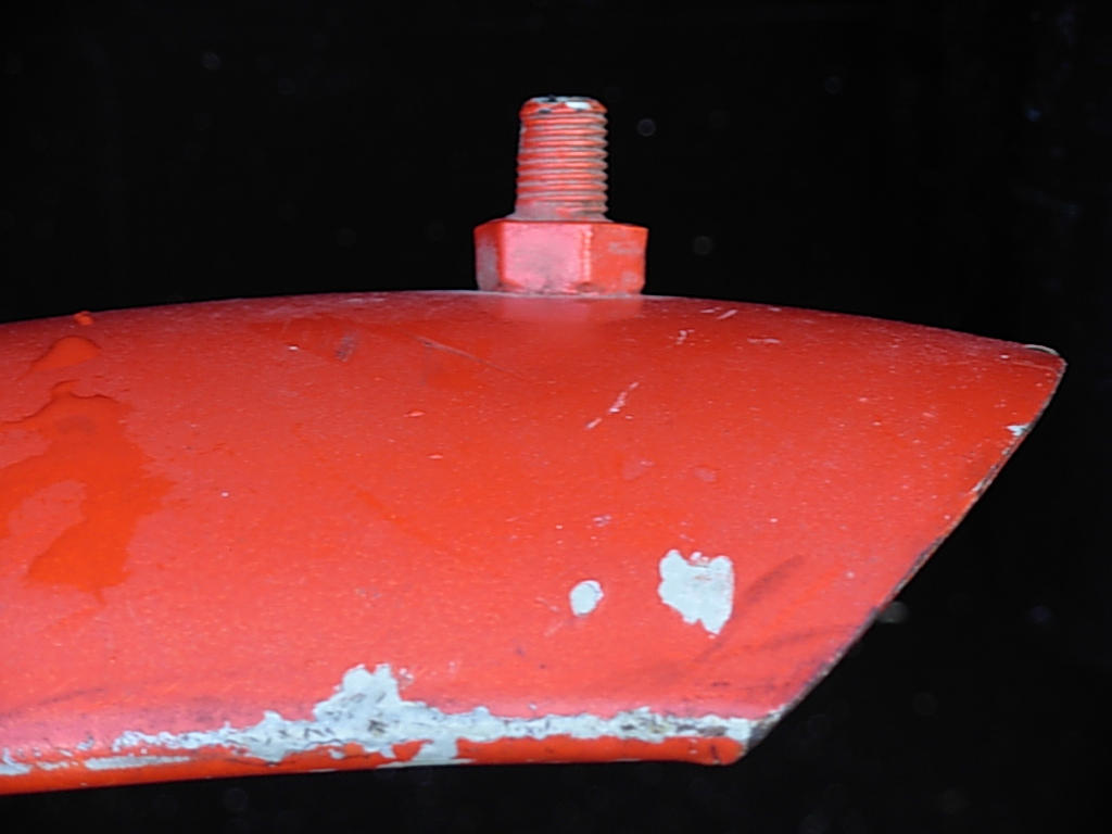

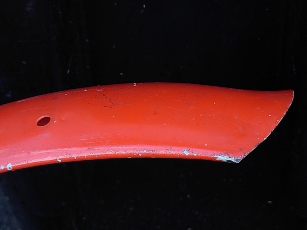

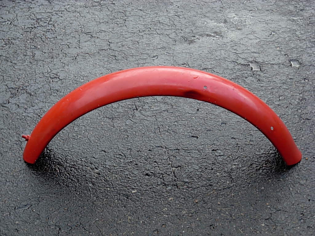

The original front fender (red, repainted from silver) that I have is missing the stay. The fender is steel, has a threaded mount on one side, 4 mounting holes, notches for the front forks and one flared end.
Is this fender typical of early CL77's? Does anyone know what the stay looks like? And finally, is there a part number for this type of stay? Thanks everyone, this site has been a great help!
As promised here are photos of the fender I have...
Full fender...
Full fender...
Close-up of the threaded mounting bolt...
Flared end opposite of the mounting bolt...

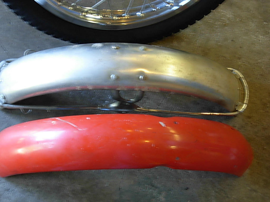

Here are two fenders side-by-side.  The silver fender is aluminum has the typical 8-hole mount for the fender stay, is about 3/8" shorter than the original, is narrower by about 1/4" and does not have a flared end.  Also note there are no notche
Post by davomoto » Wed Aug 19, 2009 8:39 pm
The aluminum fender is for a CL72. The red fender is for who knows what, but definately not a CL77. Your 65 shouuld have steel fork sliders, and a steel 8 hole fender. Sam mount bracket as the CL72 fender that you have pictured.
Post by G-Man » Thu Aug 20, 2009 10:30 pm
That red one looks like a Triumph fender. Looks a bit like the one on my '68 Daytona. The stud attaches to the rear mounting bracket which doubles as a front wheel stand. You undo the nut and the rear stay swings down to support the wheel for wheel changeouts etc.
