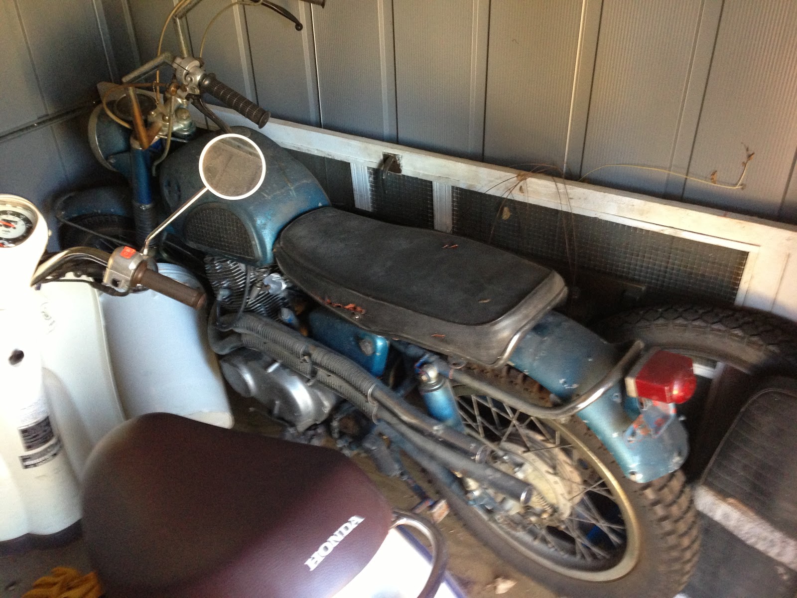

I've got a candy blue cl77 w/o side covers. Should I try to paint some covers blue (It would be single stage) or should I chrome? I am not asking for preference as much as resell. There is a 30 percent chance I get to keep it and I would prefer paint, but I may need to sell it to have $$ to restore my '65 and '64. Thus, I don't want to get beat up on something that I could easily avoid if it would irritate a collector. I have a bit of experience restoring mini trails and any modification away from stock almost always kills the value. This doesn't seem to be the case for Scramblers, though, because people cut the pipes, polish things that were not originally polished, etc. Just looking for some feedback.

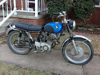

Cl77 before i started on it

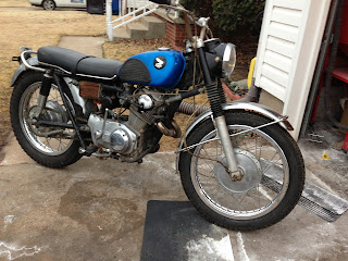

Now running and cleaned up a bit, needs more TLC which it's getting

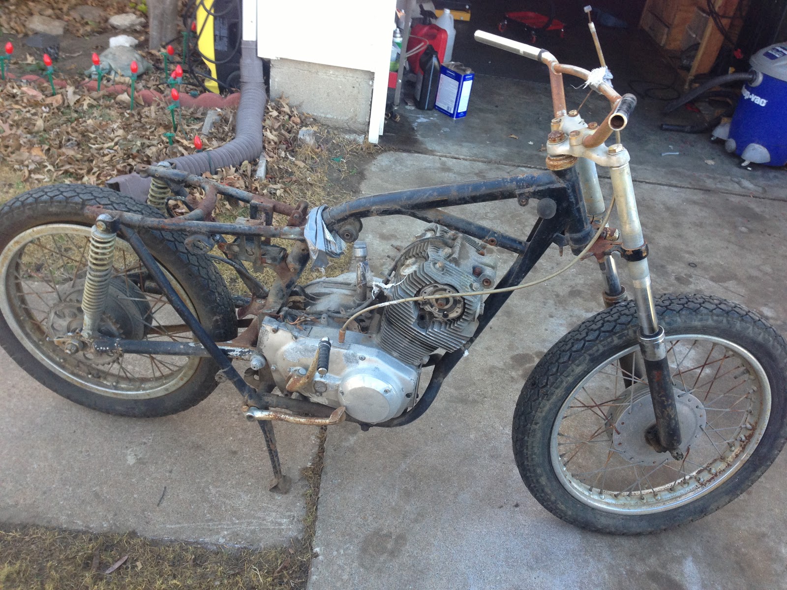

Cl72. Has one of the worst paint jobs I've ever seen. Goofy handlebars. Unfortunately I don't have a photo of it out of the shed. No carbs, but has compression. Now parts are in a box and frame will be taken to blasters and painted when its warmer.
Getting taken apart
Getting taken apart
