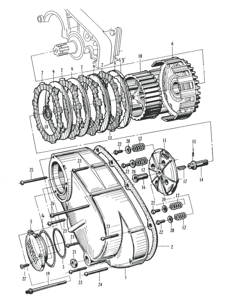

Good morning, Just discovered a small oil leak dripping from the bottom of the round inspection cover of the left engine case cover. I've tightened the screws to the point of thinking one will break. Any suggestions? Was there a rubber gasket on the inspection cover? I can't remember. Thanks Jay

If you mean the OIL FILTER cover there are 2 "O" rings. .......lm

Post by G-Man » Fri Feb 07, 2014 11:47 am
LM is spot on - see items 3 & 4
