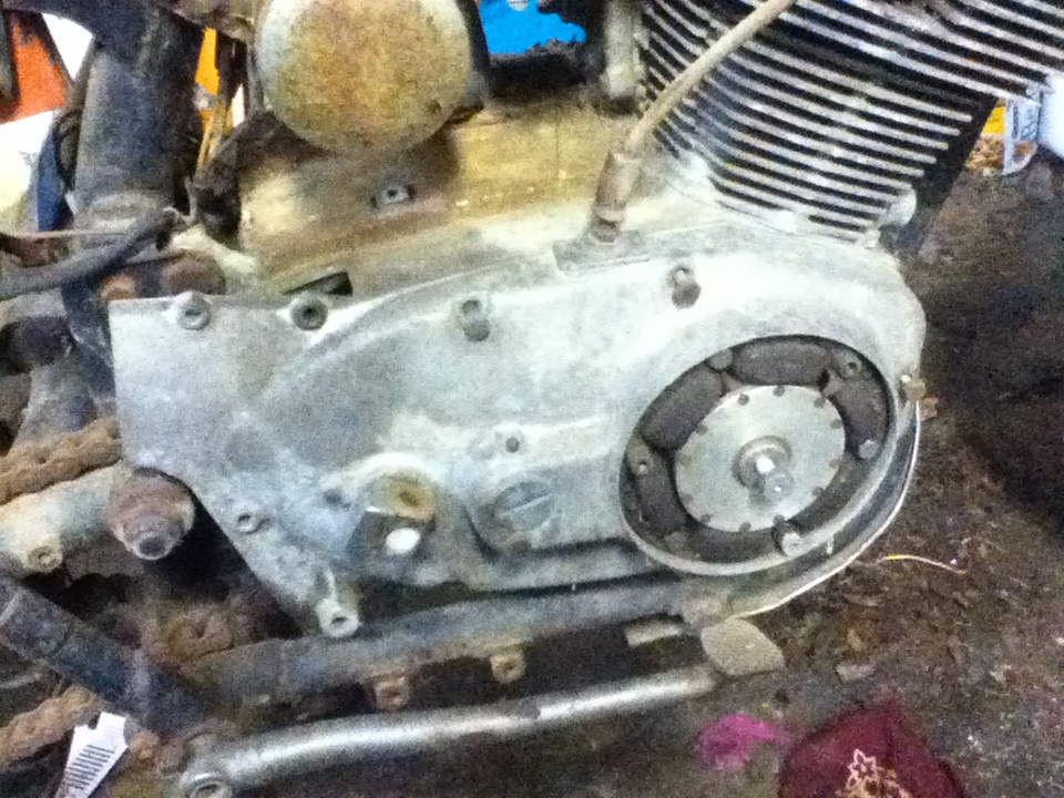

first question.... Whats the trick to removing the right side cover where the clutch cable leads through?
this cover
this cover

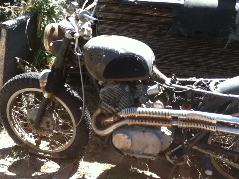

as i found her
as i found her
Post by davomoto » Wed Aug 31, 2011 7:26 pm
Welcome to the forum! I've started with worse for sure! Make sure all of the screws are removed. You'll probably have to rock the kicker back and forth. There are fine splines that that knuckle slides over, and they are probably rusty. Some GENTLE prying may also be required. Bike appaears to be a 65, small brake hubs, steel lower fork sliders. 66 and 67s had twin leading shoe brakes, and aluminum sliders. Post the VIN, and we can tell for just about sure!

Post by Hotshoe » Wed Aug 31, 2011 7:36 pm
Welcome to the Forum.
That case has a screw underneath the dyno cover that's easy to overlook.
It might help to squirt some grease into the clutch actuator and kick starter zirc fittings, they're probably dry from the looks of it.
I'm guessing that the problem is that kick starter joint (arm) is frozen onto the splined shaft it engages with inside the case.
Try squirting some liquid wrench inside the case on to the kick starter assy and tap the case gently with a rubber mallet to loosen things up.
It should come off with a bit of whiggling.

Post by PapaWoody » Wed Aug 31, 2011 11:19 pm
Got that cover off. Awesome. Looking pretty rough so far. Another question. Is there a good alternative to the old rectifiers somethin maybe silicone? And also, as far as the coils, willthosefrom an xs work off the top of anyone's head? I used xs coils on my cb on recommendation from a yamaha guy and was very satisfied. Thanks

Post by PapaWoody » Thu Sep 01, 2011 6:05 pm
Well upon removing the cover i found the rod for the clutch is missing. That worries me. Usuall when parts are missing inside, someone up the line got frustrated and neglected to put things back. But we will see
