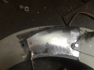

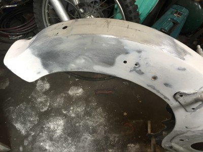

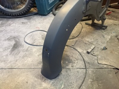

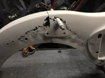

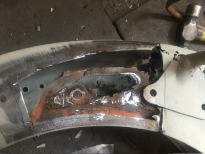

I did post the completed frame repair a while ago but for those new to site I’ll show the photos again. Being double skinned meant I had to do it in stages to avoid distortion. Once near completion I used a laser to check for alignment and tweaked the frame before finally finishing the welding.
