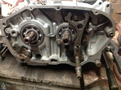

I’m as puzzled as you are about the sequence of gear selection. If you just rotate the selector drum by hand do the gears actually select in the normal correct 1 N 234? This is just a guess but, could the selector mechanism levers have been assembled wrongly or be bent. It’s a few years since I had mine apart so can’t quite remember how the levers rotate the selector drum.

Post by Geoff Hastings » Fri Jun 07, 2024 8:11 am
I could only find this one photo of the selector on my C77, it’s probably not a lot of help.
