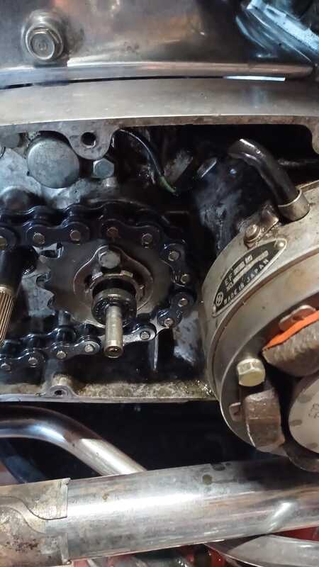

Trouble with my C72 during a vintage bike tour in Auvergne.
Stupid, undetectable failure!
The clutch rod oil seal came out of its housing and the oil drained .... into the sealed chain case. I didn't realize it because there was no oil on the engine or on me!
Fortunately, more fear than harm. I don't seem to have any damage other than a piston that tightened.
As I've got some C77 parts, I'm going to upgrade my 250 engine to a 305 CC.
That's a bit of work, as I'll have to change the crankcases and the cylinder head, so I'll have to transfer the parts from one to the other...
