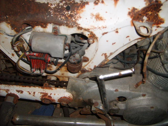

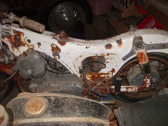

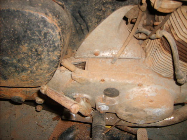

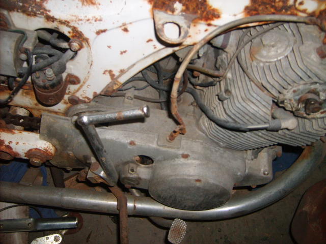

Post by choppermtn » Sun Feb 02, 2014 1:22 pm
Thanks for the help . I do see that the side cover has the cut out for the early clutch cable , also I have the seat and tank on the ca72 but it still looks like the rear of the tank has too much cutout at the seat. Here are some pics. I will restore the white one as it runs and the black one will be for parts. Mabye I can trade some of the early parts for the ones I need I really want to make the white one correct as possible.
Posts: 5681
Post by G-Man » Sun Feb 02, 2014 2:28 pm
If the tank ornament (central chrome strip) on the '62 is in good shape - it is probably worth more than you paid for the bike. That tank with the bug eye panels is quite sought after. There was a guy on the forum in desperate need a while back.

Are your rear shock top covers on the white bike metal or plastic? And on the black bike?
