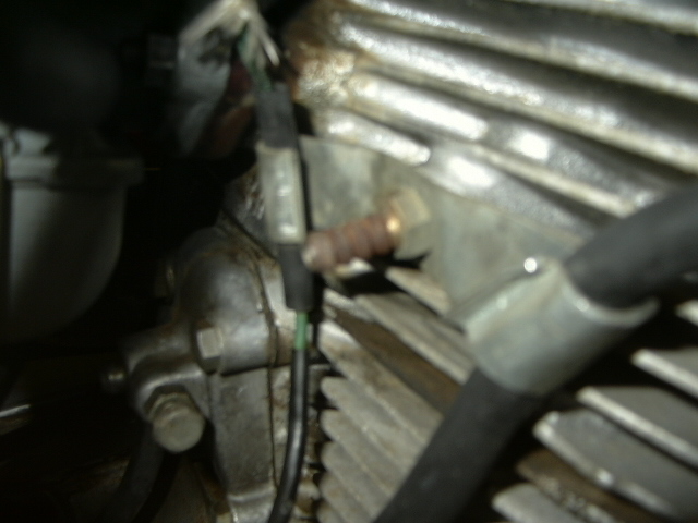

should these vent barbs on my CA77 have a hose attached to them. If so, where does the other end go? Thanks for any help. woodsie

Yes. Tubes on them and then there are holes in the air filter housing for the other end of the tube. These vents were deleted on later bikes. I have replaced the barbs with a bolt on a few motors.

I just plugged mine using poly caps which I use on cars mostly till I get around to replacing with bolts.
