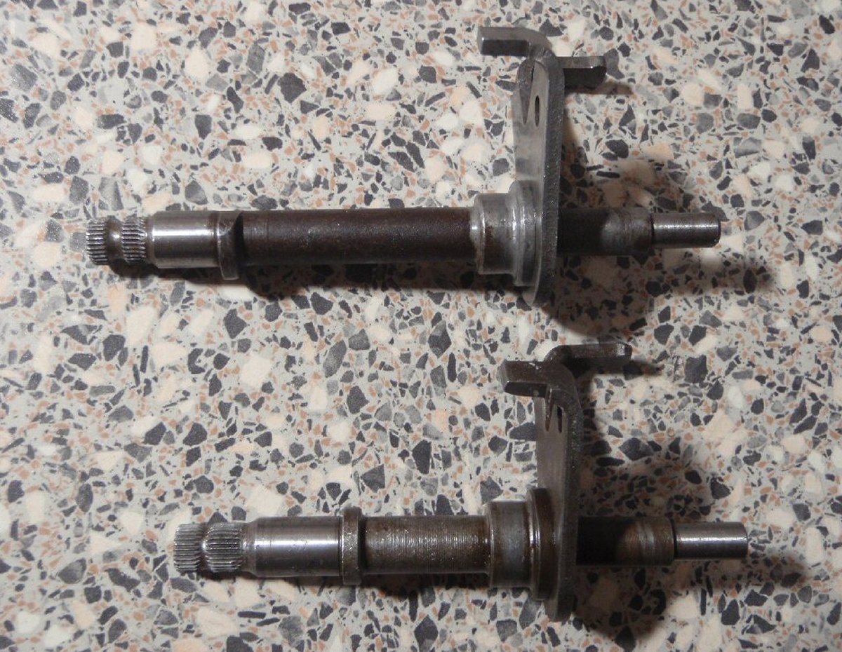

Post by jensey » Sat Jan 23, 2016 4:04 pm
Hi,
Here a long and short version
Jensen
long and short version.jpg (265.56 KiB) Viewed 2902 times

Post by G-Man » Sat Jan 23, 2016 4:50 pm
Jensen
Are the spline diameters different? Difficult to tell from the photograph.

Do you have one of the 2 shown.
Give us some feed so we can help better. ....................lm
