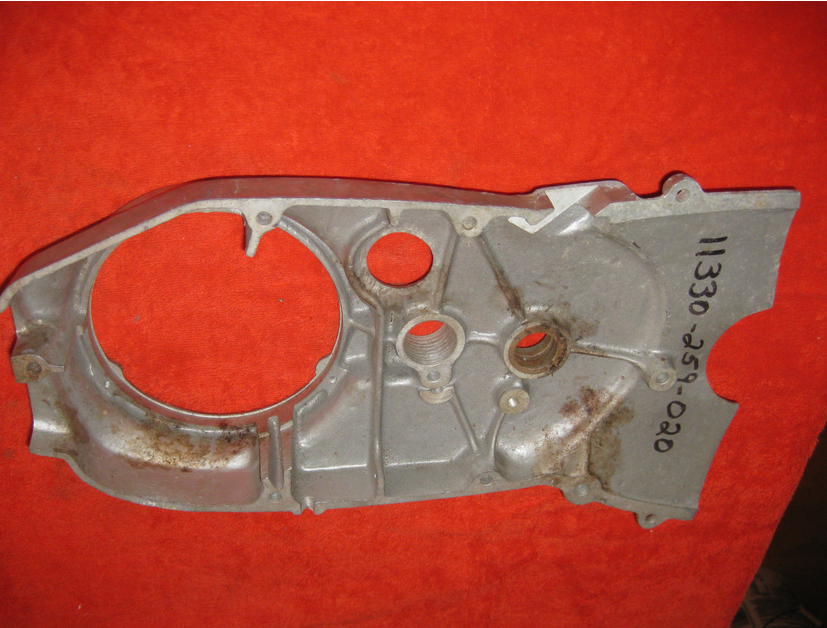

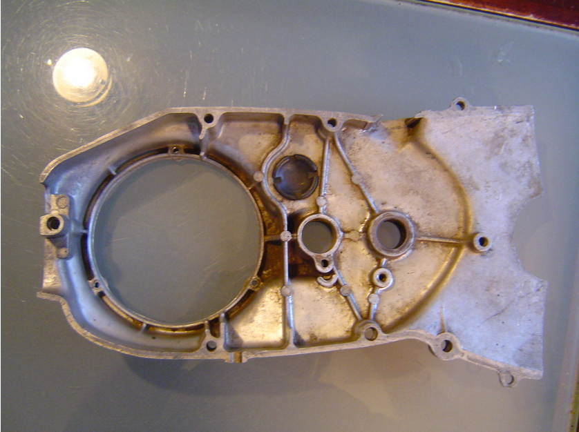

I was looking at these two pictures and they seem to be a little different. The part I need is the 020 version. But this 020 version looks a little weird. Can you guys tell if it's legit?
Specifically the slot where the clutch cable enters the casing. The red background picture looks a little too different...
"Normal"
"Different?"

It looks fine to me. It looks to have been cast in a different production run/mold but still is the correct part for the early clutch cable routing.
