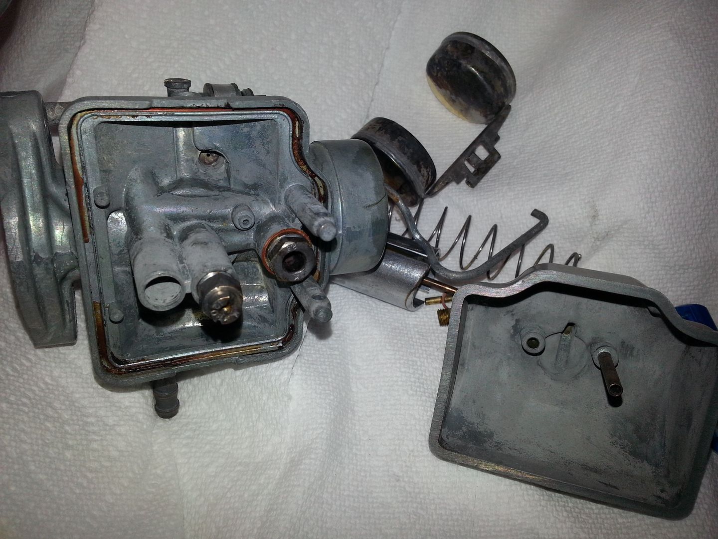

Carb is looking much better, waiting for the carb kit so i can swap out the idle jet, the float valve and needle and the bowl gasket.

If I were you I would clean up reuse the original carb parts. The parts in the repop carb kits are no where near the quality of the oem parts.

DONZIE wrote:If I were you I would clean up reuse the original carb parts. The parts in the repop carb kits are no where near the quality of the oem parts.
yeah i know this Donzie, but I need a new needle valve and idle jet, period. These are unusable, the rest is useable however. I awlays try to re use when i can. thnx

fired her up today. runs great. using a stand alone tank. im still cleaning out the original tank. ill post up a vid later.
